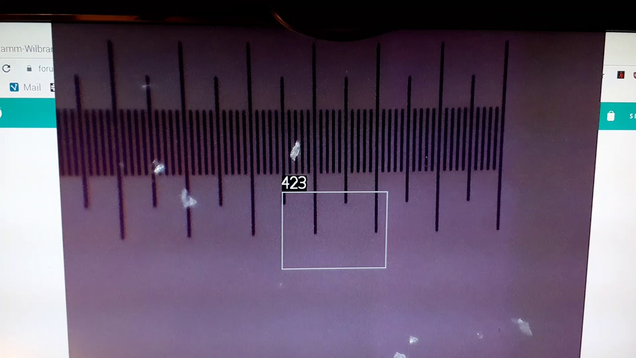

This is 100% view of part of 12MP photo with 0.21µm/px:
(micrometer diversions are 10µm apart, measured line is 150µm long, and 714 pixels)

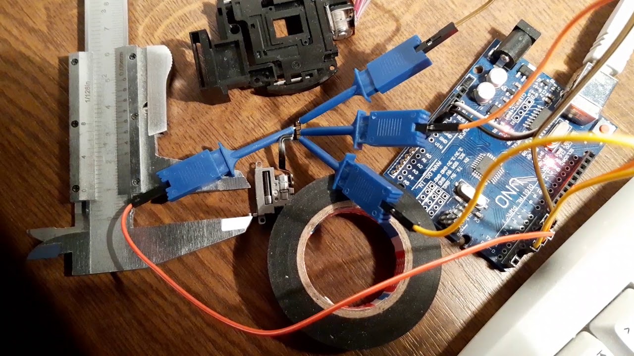

3.57µm per step allows for 14 steps per 50µm, and that is the side length of the center micrometer squares.
Unlike the current mini stepper motor, the two sliding table motors have tiny springs attached, so positioning there might be more precise than with currently tested mini stepper motor.
As sneak preview I did first video of sliding-table µm movement.
Under Raspberry HQ camera 0.21µm/px microscope view of scene.
5 loops of 4 full-steps making 142µm is 7.1µm per full-step (micrometer diversions are 10µm apart).
https://www.raspberrypi.org/forums/viewtopic.php?f=43&t=210605&p=1677348#p1677348
16.6% size 30fps animation of first 6 seconds of video:
This is kind of a hello world sketch for two-axis microscope sliding-table.
It does 40 half-steps to the right, then 40 half-steps up, and finally 40 half-steps of both stepper motors in the other dicrection, together:

  delay(1000);  for(; y<N; ++y)  step(1,y+1,d);
  delay(1000);  for(; x>0; --x,--y)  { step(0,x-1,0); step(1,y-1,d); }
I did upload 17s 1920x1080@30fps smartphone video of Raspberry microscope view with Figure of Merit:
Right side of Figure of Merit rectangle moves from position 21 to 41 with 40 half-stepper steps. That is 200µm/40=5µm per half-step.
New demo.
4×zoom of Raspberry HQ camera preview made pixels of 12MP frame correspond to (1360x768) HDMI display pixels 1:1.
Now moving 20 steps or 100µm right, then up and finally diagonally down to start (center of micrometer diversions 10µm apart, or 48 pixles):
https://www.raspberrypi.org/forums/viewtopic.php?f=43&t=210605&p=1678566#p1678566
I completed soldering of 2nd stepper motor from two-axis microscope sliding table and superglued 8 female headers to an 8×1 connector:
https://www.raspberrypi.org/forums/viewtopic.php?f=43&t=210605&start=75#p1678566
I did not measure current of tiny stepper motor coils I drive directly from Arduino digital pins until yesterday. I was lucky, the rmeasured 21mA should be OK (Uno datasheets says digital pins can deliver 20mA).

Now that X and Y direction of sliding-table can be addressed with 5µm steps, I found it annoying that Z axis for focusing is done manually. With 180° M12 lens mounted reversed as macro lens, not only a big maginification is achieved (0.21µm/px in 12MP photo), but also the depth of view is reduced. Even with microscope stand wheel it is not easy to do the needed moves and not overshoot.
I looked at my microscope stand and thought about superglueing 28BYJ48 stepper motor to center of wheel. It turned out that there was no plastic in order to allow access to inner screw. After removing thin plastic the screw became visible. I have some 5mm to 3mm couplers, and it was possible to superglue the 3mm side of coupler centered onto the microscope stand screw nut. I did superglue some Lego pieces to stand as well, allowing to finally superglue stepper motor onto the Lego pieces with motor shaft freely inside 5mm side of coupler. After waiting some time to complete superglueing, I did screw in two tiny screws that fixated the coupler to stepper motor shaft (in case I do not want to use the stepper motor, just unscrewing the two screws a bit allows the coupler to turn without being affected by stepper motor):
Then I connected stepper to uln2003 motor driver, and connected unused pins 6, 7, 12 and 13 to IN1-4 of uln2003 stepper driver. Simple full rotation example is what you can see in video uploaded to youtoube. 2048 full-steps down, then 2048 steps up, repeat. I did mark highest and lowest position reached on microscope stand and let the sketch alone for an hour. Stepper is moving fine, and maximal and minimal positions have not changed.

I wanted to do a quick test with fine grain Z-axis movement and live microscope view. I modified sliding-table sketch for one input only, and use stepper library:
#include <Stepper.h>
const int stepsPerRevolution = 2048;
Stepper myStepper = Stepper(stepsPerRevolution, 6,12,7,13);
  myStepper.setSpeed(10);  // 10rpm
  while (!Serial)  { }
  Serial.println("\nZ micrometer moves:");
String inString = "";
int nz, s=1, z=0;
  while (Serial.available() > 0) {
    int inChar = Serial.read();
    if (isDigit(inChar)) {
      inString += (char)inChar;
      Serial.print((char)inChar);
    } else if (inChar == 45) {
      s = -1;
    } else if (inChar == 13) {
      nz = s * inString.toInt();
      myStepper.step(nz-z);
      z=nz;
      Serial.println();
      inString = "";
      s = 1;
I started Rapberr Pi HQ camera microscope view, and in left bottom terminal you see my inputs. I did move 1 stepper motor step deeper each time, that means 8.8µm per step. I took 1360x768 screenshots after each move and created animated .gif from captured frames. Right click to see animation in 100% size:
