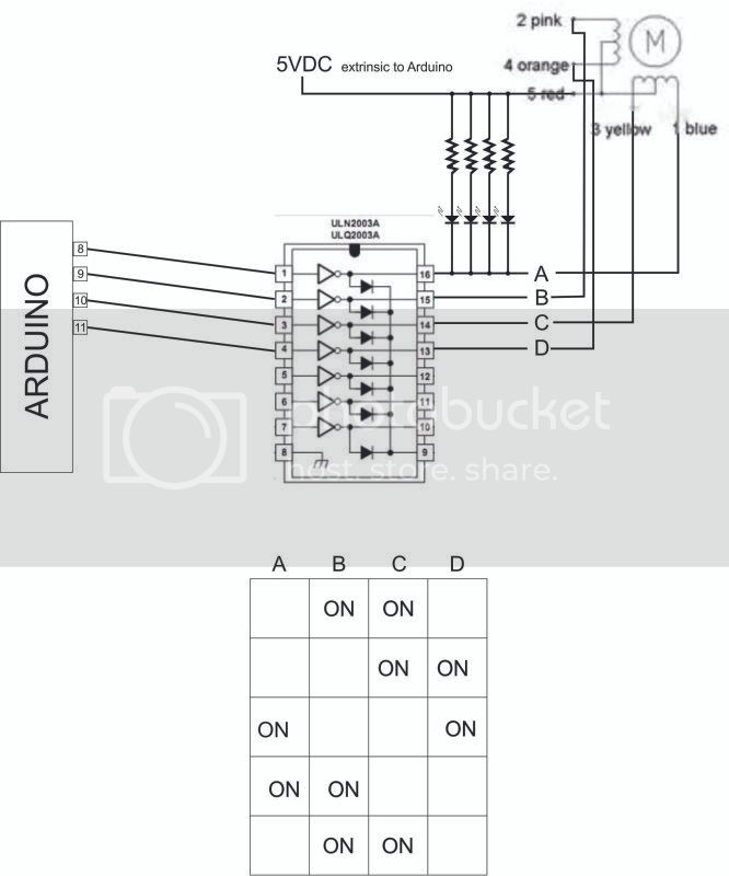

I’m not working on any project. Simply fooling around with a 28BYJ-48 stepper motor and driver board I got very cheaply off of ebay. I have the motor mounted to the back of a piece of board with the output shaft protruding from the front of the boad and an arm attached to the output shaft. The the output shaft is attached a three inch arm. Imagine a clock. Using this code:

The arm swings around to what visually looks to be 360 degrees, pauses briefly, and repeats forever. I have marked where the arm stops. There is a brad sticking out of the end of the arm and the brad is close to the surface of the board so I can mark the stop position pretty accurately. After only a few minutes the brad is off from where it was originally marked. I have tweeked the number of Steps2Take by 2 but have not come up with the magic number that will make the arm stop consistently at the same place. Now I’m beginning to think that the stepper motor is not capable of being that exact. For instance is there an overrun in movement when it stops? Then I think of all the CNC machines that can provide absolute accuracy. Do they ramp down before stopping? Or have I just not found the magic number?
Another thing I wonder about is the Steps2Take for a 360 degree rotation. The spec sheet http://www.motionsolutions.us/motors/Stepper_Motors/Geared_Steppers/24_28_30BYJ.pdf says its 5.625 degrees per step for 64 steps per revolution of the stepper motor. The stepper drives reduction gears by a 1:64 ration. I come up with a total of 4096 steps per revolution of the out put shaft. More than double the number of steps I am using.

Now I'm beginning to think that the stepper motor is not capable of being that exact.
Yes it is.
You are probably going too fast and the motor is missing a step or two. Slow things down and see if it helps.
Maybe speed, but you're only going 100. 4096 half steps. 2048 full steps. Another possibility is that 2 of your wires are swapped incorrectly, this would cause it to skip some steps. It should work the way you wish. Did you see my code in this forum?

I see some other posts in that thread somenthing about the improved torque of this motor when using your code. From the data sheet I concluded a torque of about 4 in oz. Is that what can be expected?
Thanks for your replies Gentlemen. - Scotty
Not while you have LEDs in series with the motor winding. It is probably that which is limiting the torque to the motor and causing it to skip.

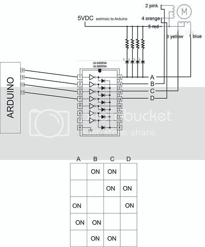

I see you have now corrected the diagram, does this reflect what you actually have?
Yes, the current diagram is now correct.

That's confusing to me. Swapping 9,10 should make a difference, without changing the code. One way is right, one way is wrong. It may not affect your total count, as you have observed, but it will not step in the right order, individual steps I mean. This could lead to...
Skipping, ahead, not behind.
You don't have to go THAT slow. It takes too much time to do an experiment at that speed.
What surprises me is that you're so close to being correct. I have seen a similar closeness when starting full speed and stopping without gradual accell. It only misses a few steps at the beginning. You case is different. I don't understand your symptoms. Try going at your speed of 1 and see if it takes tiny steps, equal size, equal time, all in the same direction. Not jerky or uneven.
First, thanks for continuing to respond with help. I went back to a speed of 1 taking 1 step at a time in the loop. I checked the arm's movement with a magnifying glass. Can't say the movement is consistent. It does not move backward. The forward movements are regular in time but not in distance. I can't pick out a pattern. It seems random and I suspect this may be due to the slop between the gears. When you previously suggested switching pins 9 & 10, I switched them in the code. Is that ok? - Scotty
Sure, code or wires. One should be regular in distance. Switching them should not. I don't know which order is correct. There is no slop between gears. It should move the same distance every time. You''re on the right track looking at this.
I switched 9 & 10 again. The distance the arm moves is consistent now but it moves only on two of the four coil energizations (I think I just made a new word).
LEDA LEDB LEDC LEDD ON ON OFF OFF No movement OFF ON ON OFF Arm moves OFF OFF ON ON No movement ON OFF OFF ON Arm moves
