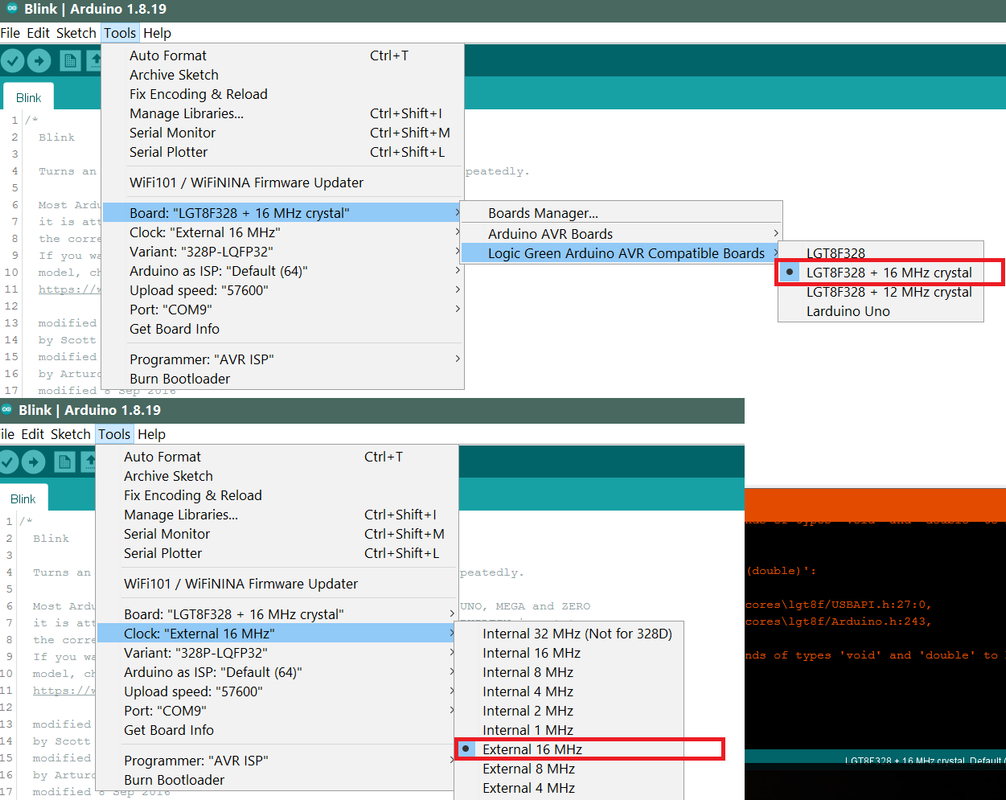

I have this board:
It has External 16Mhz crystal.
I have downloaded the boards.txt from
But I get errors compiling when choosing the external crystal?
What I'm doing wrong?
c:\program files (x86)\arduino\hardware\tools\avr\avr\include\util\delay.h: In function 'void _delay_ms(double)':
<command-line>:0:8: error: 'build' was not declared in this scope
In file included from C:\Users\user\AppData\Local\Arduino15\packages\LGT8fx Boards\hardware\avr\1.0.6\cores\lgt8f/USBAPI.h:27:0,
                 from C:\Users\user\AppData\Local\Arduino15\packages\LGT8fx Boards\hardware\avr\1.0.6\cores\lgt8f/Arduino.h:243,
                 from sketch\Blink.ino.cpp:1:
c:\program files (x86)\arduino\hardware\tools\avr\avr\include\util\delay.h:174:19: error: invalid operands of types 'void' and 'double' to binary 'operator/'
  __tmp = ((F_CPU) / 1e3) * __ms;
c:\program files (x86)\arduino\hardware\tools\avr\avr\include\util\delay.h: In function 'void _delay_us(double)':
c:\program files (x86)\arduino\hardware\tools\avr\avr\include\util\delay.h:263:19: error: invalid operands of types 'void' and 'double' to binary 'operator/'
  __tmp = ((F_CPU) / 1e6) * __us;
exit status 1
Error compiling for board LGT8F328.

How did you get option for 16Mhz Crystal? My version has 32Mhz only?
The one I tried is lgt8fx/lgt8f at fb4f06a097e6a225a20d1b78d7e70eac160a6d5b · dbuezas/lgt8fx · GitHub
I downloaded original chinese driver now it works
my settings
driver
The CPU must be set at 16Mhz, crystal external 16Mhz.
