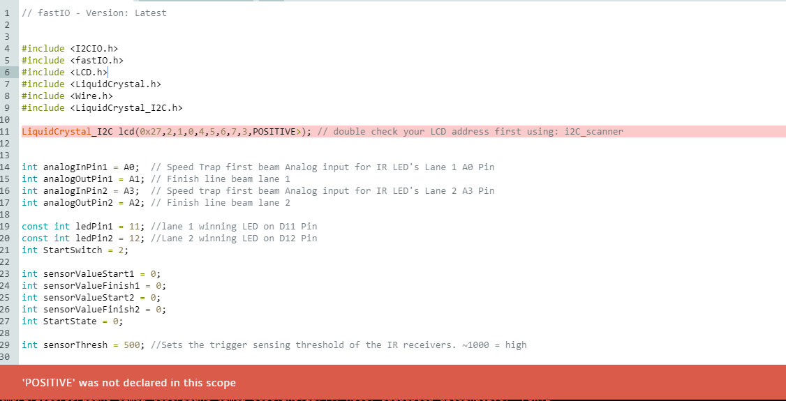

OK, got that one fixed and moving on, now I'm getting this... I have verified 0x27 is the correct address.
This error is caused by using a different "LiquidCrystal_I2C" library than the one your sketch code was written for. Unfortunately, there are multiple libraries which contain a LiquidCrystal_I2C.h file and they have incompatible APIs.
I'm going to ask you to post some additional information that might allow us to provide you with instructions for fixing this.
Please do this:
  1. From the menu on the left side of the Arduino Web Editor window, click "Preferences".
  2. Check the box next to "[ ] Always show output panel".
  3. Check the box next to "[ ] Console: Show verbose output".
  4. In the sketch pane, click the :heavy_check_mark: (verify) button.
  5. After the compilation fails, click the icon in the top right corner of the black console window at the bottom of the Arduino Web Editor window that looks like two pieces of paper.
  6. In a forum reply here, click on the reply field.
  7. Click the </> button on the forum toolbar. This will add the forum's code block markup (```) to your reply to make sure the compilation output is correctly formatted.
    codetags
  8. Press Ctrl+V. This will paste the compilation output between the code tags.
  9. Move the cursor outside of the code tags before you add any additional text to your reply.
  10. Click the Reply button to post the output.
Here you go. I deleted the Liquid Crystal file and downloaded one from the LCD manufacturer. It will properly display an example "hello file" but when I put in my program, it doesn't work, just a blank screen. It's odd that it works in one program but not the other.
