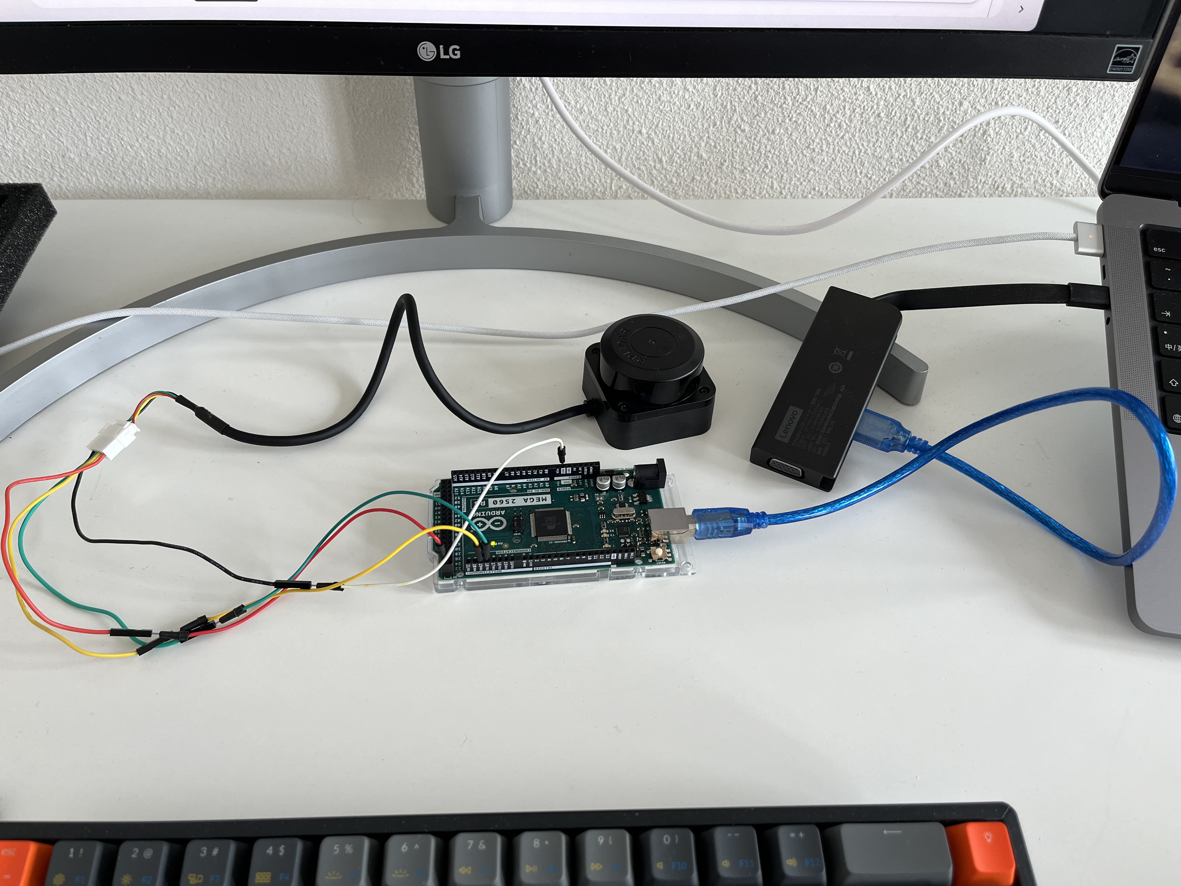

Also serial setup in your code is still not ok. You set serial (for serial monitor ) at 460800 baud rate and serial1 for lidar baud rate is..?
Doesn't match with the wiring in your post #21

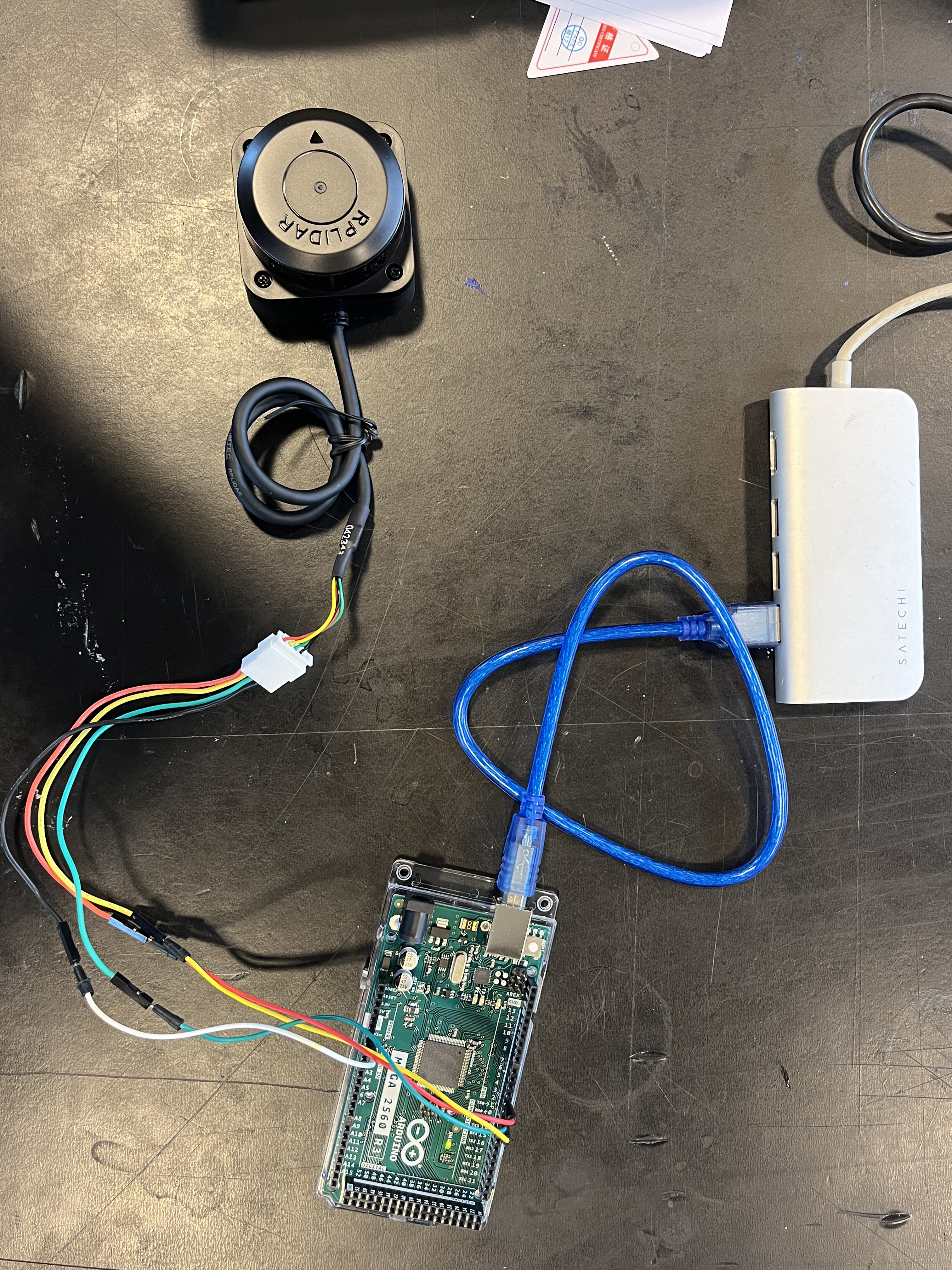

Serial1 is 18tx and 19rx (like in post #21), but in foto something else.
Also that usb hub is a big uncertainty to mee..
Try to concentrate!
baud rate is the same 460800, I readjust the wiring on 18tx 19rx of Serial 1, it shows "RPLIDAR not detected. Trying again...".
serial monitor baudrate in your code and on serial monitor have to match! You set them 115200 both.
The RPLidar team told me this morning the baud of C1 model is 460800, then I changed the setting both in the code and serial monitor to align with that. ps: I'm kept updating the situation in the origin info of the question.
That has nothing to do with serial.begin()
The RPLidar team told me this morning the baud of C1 model is 460800, then I changed the setting both in the code and serial monitor to align with that. ps: I'm kept updating the situation in the origin info of the question..
if you don't follow instructions, I'm not able to help you.

Also, that hub is probably not ok.
Also in your photo your lidar Vcc (red) is connected to some random digital pin of Mega!
You really aren't following at all!
Look, I have to go now.
If you carefully read everything I wrote to you today and follow my instructions for serial communication and power supply, you are able to power your lidar correctly and establish serial connection with your pc and serial1 connection with lidar. -If you didn't damage your Mega with your random wiring.
I have no idea if your code related to lidar-library is correct or not.
But by now I have even doubts that your lidar is compatible with your library.

About the power supply, I did some research for the Adruino Mega and RPLidar C1 they both ran properly at 5v and Macbook Pro thunder bot 4 can provide enough supply.
After I modified the code and setting with GPT for the whole night, I still could not generate useful data sadly.
The wiring is RPLidar (RX/TX) >Arduino Mega serial 1 port, RPLidar GND>Arduino Mega GND, RPLidar Vcc>Arudino Mega 5v

Both TX and RX of RPLidar C1 have been connected to Serial 1 port 18Tx1, 19Rx1 on Arduino Mega.
About the power supply, I'm using the Lenovo USB 4 in 1 port connected MacBook Pro Thunderbolt4, the output of the port is 5v, 1.5 A.
I test the connection between Mega and Macbook pro with the example code 'Blink' it does work.
I will attach the wiring graph and real situation footage below, thanks for your help.
