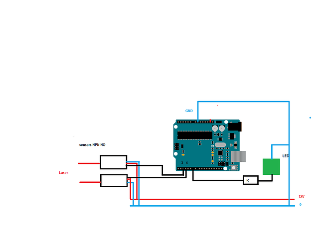

Draw a sketch showing how everything in’s wired.
Show power supplies, signal names etc.
Clear photo of a clear pen drawing is fine.

And I'm sorry to say the diagram you posted now is almost unreadable, please draw it with a circuits tool or emulator (like WokWi or TinkerCAD) and post it again making sure you haven't overlapping wires.

sorry about the sketch im new in this, ill try to better it
What are supply specs of the lasers and the LED ? (V, mA, and possibly W)
No +V supply to the arduino?
Grounds aren’t tied together ?
Generally speaking, don’t think of the Arduino as a power supply - only if the total load is minimal,
laser: 6-36V, 300mA
LED: 2,3V, 20mA
sorry there is supply 4,5V to arduino, and grounds are tied together

You can’t power those from the Arduino 5V pin.
Connected how?
Connected to 12V or 5V

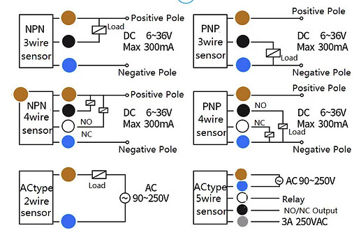

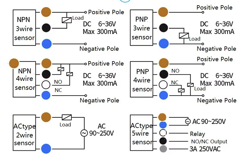

I found this for the E3F
Seems like the load voltage minimum is 6V, so it may not work for 5V
