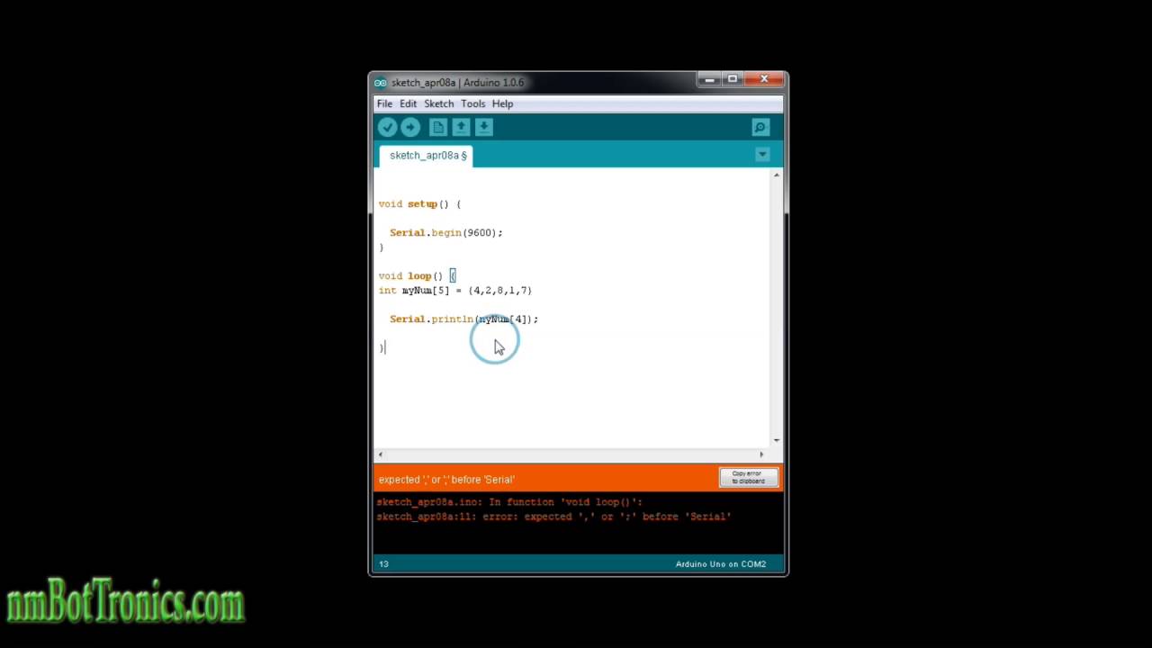

UPDATE: If anyone reading this needs help with arrays, this YouTube video helped me a lot.
