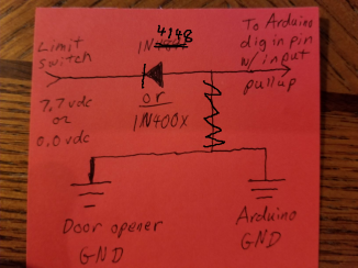

If you are SURE it’s DC then this might work, diode prevents 7.7V from getting to Arduino pin, but limit switch can still pull the pin low, don’t forget to pinMode the pin to INPUT_PULLUP in setup(). And BE SURE the limit switch voltage is POSITIVE with respect ground.
BTW: That “encoder” looks like a simple pulse generator but can’t really tell from picture.
No need to use a Schottky here, a regular diode (1N4841, 1N400x) will do just fine. R1 and C1 are optional, and slow down reaction.

@outsider, thanks for the diagram, and your “BTW” comment encouraged me to look closer at the wiring diagram I attached to post #3 from the owners manual (page 33). I didn’t see this until now, but it shows that the orange wire is the signal wire. That’s the bottom terminal in the picture I attached to post #7. Since that terminal measured 4.15 vdc as I mentioned in post #7, do you guys think that signal will be okay to connect to the Arduino directly? Seems logical to me. :astonished:

Lose R1 and C1, use software debounce, simpler hardware :slight_smile: The diode doesn’t need to be
schottky, a common-or-garden 1N4148 will be fine. A modest value of R1 like 4k7 can be
used for more protection (it needs to be an order of magnitude lower than the internal
pullups).

You have a wire from the input pin wire to ground, that’s grounding out your signal, remove it.
When that is done, put your meter on the 50 DC volt scale first, put black lead to ground, red lead to input pin, if less than 10V, switch to 10V range, you should see about 5V when the switch is open and near 0 when switch closed.

I think I’m still confused some after your revision to my drawing. Does this new drawing make sense?
Like this.
