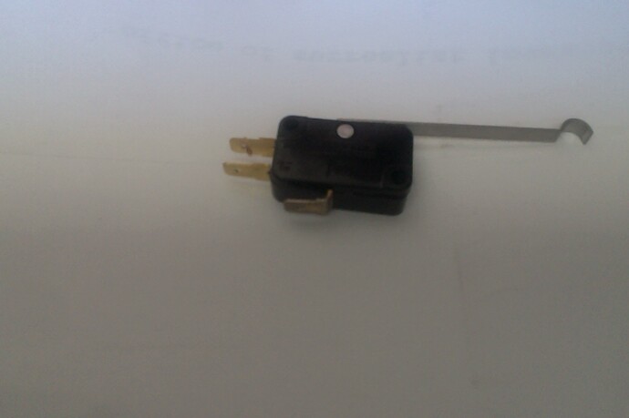

Limit switches to trigger forward and reverse movement of motor
I am fairly new to the Arduino and need help developing a code that enables a mobile object to move between two limit switches continuously. In the final code there will be four individual mobiles that will each have 2 limit switches that guide their movement up and down, but once I have code for 1 mobile I assume I can copy and apply it to the others.
Here is the algorithm: When the top limit switch (limitsw_u1) is pressed it triggers and sustains the state of downward movement until the bottom limit switch (limits_d1) is pressed which triggers and sustain the state of upward movement. This repeats.
Here is a video of a similar type of function: Forward/Reverse Direction control of Induction motor using Limit Switches - YouTube
As for the limit switches, what is the proper way of wiring them into this circuit (i've attached a photo of my limit switch)? I was attaching 5v to the common, and attaching a wire from NO to an input pin.
Here is the code I used (i've also attached it, if that is easier). Note, as I am fairly new to the arduino, some of the code language is probably not used correctly:

One additional comment. On your original program, you were attempting to debounce the limit switches. With your implementation, that is not needed. The reason for debounce is when your program has very little work to do and will quickly test the switch multiple times. Your program only needs to test a limit switch that will become active in the direction the box is moving and unless it is moving very, very fast any bouncing will be long gone.
Also, you will probably need to stop the box movement before beginning to move in the opposite direction.

I have attempted to read ALL the switches and their current states first [ (limits_u1_State = digitalRead(limits_u1); ] then move the first motor function [ void moveMotor1() ] but I can't seem to get it working. I believe I am properly recording the states of the limit switches, and I tried implemented the if {} else {} statements and many variations of it instead of while{}...
Here is the main part of the code I am working on:

This other code that is designed for 1 motor function still works whenever I plug it in to check if the system is working:

It doesn't seem like I need a stop function before beginning to move in the opposite direction. I have tested the last code I posted with the motor and mobile object and it seems to reverse fine.
leviglass:
The mass must be pretty low. You might want to measure the current draw for the motor when you reverse, and then multiply by 4 in case you reverse all motors at the same time. Be sure there is power enough.
Paul
This code is working to a degree. Motor1 (involving both limitswitches (u1/d1) and relay pins (up1/down1) is working perfectly, but there is a major delay in the response of Motor 2 (up1/down2).
Robin2
One of the things I could not figure out was how to make the digital-read section that immediately follows the void loop its own enclosed function {} and then how to make the following functions as variables of this initial read.
