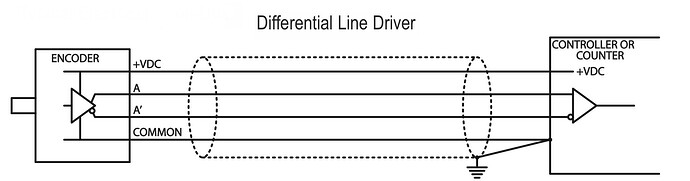

I rather not ușe any limita switches, i want tot keep the system as simple as possible. It does have an encoder, but ,as i said, i cant figure out how tot use that information because i have no manual for this actuator. It has 12 wires to the motor+encoder, so i could find A+/A- and B+/B- to connect with the driver. It also have Com A and Com B wires (found in a presentation manual) but, because my understanding is very low in this field, I cant find a way to use those Com ports.

A and B pulses are easy to code, the sample rate of the Arduino is a bit slow for an incremental encoder however, unless you move it slowly or have a low PPR value. A shield may have an integral HSC. A+ A- B+ B- is states not wires or pins. Absolute encoders don’t give pulses out only absolute information, so if your built in encoder is incremental you’ll still need to use a known reference to set up your datum, manual or not.

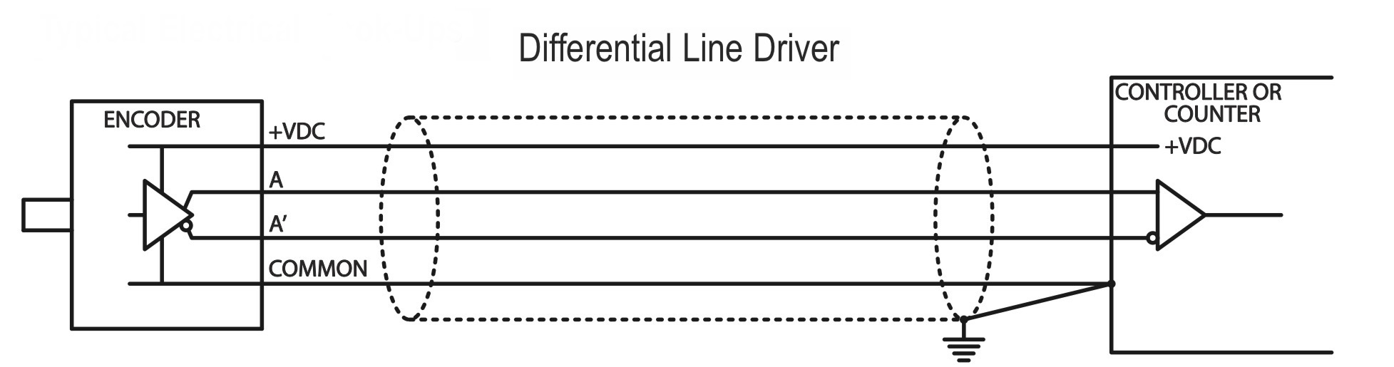

As suspected it’s differential signals from channels A and B of an incremental encoder. So Ā is the reference to a comparator and A is the signal to compare. If A>Ā then it’s a logical 1 to the μC. If A<=Ā it’s a logical 0. Channel B is the same but 90 degrees out of phase. The phase shift lets you decide direction of travel, not just speed and distance traveled.
