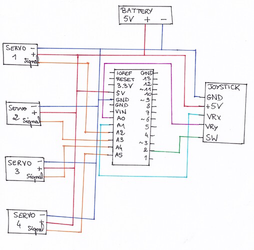

I’m Lily and I am a complete beginner with programming. It would be awesome if I could benefit from some guidance to finish my ongoing project: a lion head I made with resin, with animatronic eyes and eyelid (see pictures).
I took inspiration from other projects and tried to adapt it to mine. I went as far as I could in the process of programming and creating a circuit, and having my work checked would be truly great (I don't want to burn or break something...).
PROJECT DESCRIPTION
The eyes mechanism is 3D printed and uses 2 servos (picture above), that allow the eyes to move in all directions (x and y axis simultaneously, one servo per axis). It is controlled by a small joystick. The goal:

THE CIRCUIT
To make it "visually easier", I took a shot of one component individually then the full circuit (PDF normally attached to this post)
Circuit pictures.pdf (683.4 KB)
MY BATTERY CALCULATION
Arduino (x 1): max voltage of 5, or 12 V? (not sure of this)
Current: 19 mA
Servo (x 4): max voltage 6 V
Current: 800 mA
Thus 800 x 4 + 19 = 3219 mA = 3,2 A
Battery: 6 V with 3,2 A. Is a 6V battery good to use?
