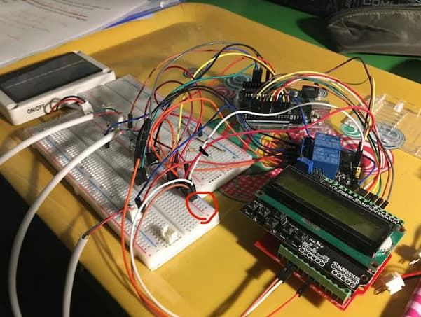

Here are the photos of the assembly in question:

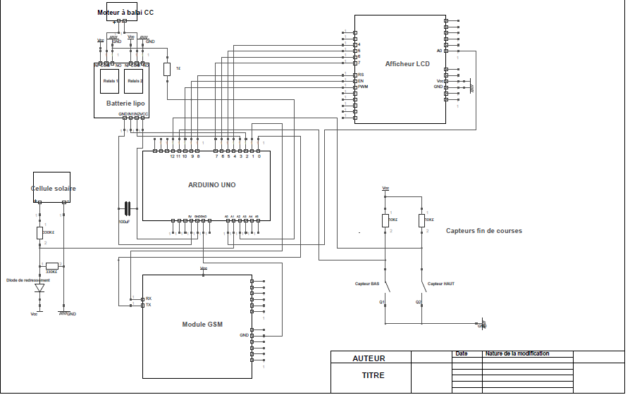

And here is a diagram showing the assembly. Note that the "GSM module" part, which is not present on the assembly, should not be taken into account:

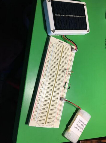

So, I decided to make a typical assembly comprising resistors, a rectifier diode (to prevent the battery from discharging), the solar cell and the lipo battery in question.
I left this assembly illuminated by the sun for 2 hours while the battery initially had a voltage of 3.56V. But 2 hours later, by measuring the voltage, the cell did not charge at all!

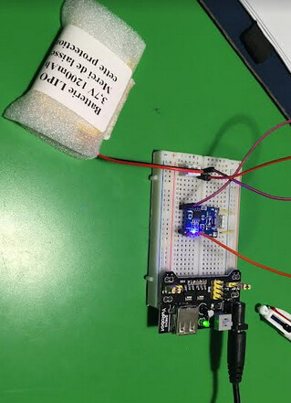

I decided to do otherwise and recharge the lipo battery this time with a 5 V generator, a voltage regulator (provided by my internship supervisor) and a mains unit to power the generator:
I then recharged the battery several times for several hours (or even overnight), but the battery is either recharged very slowly or not at all.
Do you think I have to do something else to recharge my battery?

LiPo batteries need to be recharged according to a certain protocol or they will be quickly destroyed.
They are also very quickly destroyed by overdischarge, and need protection circuitry. Some cells come with protection circuitry built in, and if you have one of those, it may need resetting, as it could be preventing you from charging the battery.
There are charger modules designed to work with solar cells, like this one: USB / DC / Solar Lithium Ion/Polymer charger [v2] : ID 390 : $17.50 : Adafruit Industries, Unique & fun DIY electronics and kits
You should do some research on the topic before proceeding.
Matching equipment is important in this sort of problem. We really need technical details of the solar cell and the batteries and the other components you're using like what value resistors and how connected. Pictures are not technical specifications.
Steve
get a Lipo charger - don't mess around with charging. You can destroy your battery quickly but worth you can light a fire if you are doing stupid things...
There are solar ones - from Adafruit for example or on the store
