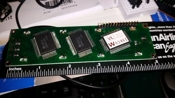

As far as I know only the true 1-line displays are capable of displaying the 5x10 pixel font. The problem is that those displays are quite rare since the majority of 16x1 displays are actually configured as 8x2 displays. The displays that use only a single HD44780U (or equivalent) controller fall in that category. In order to be a true 16x1 display there must also be an auxiliary controller (HD44100 or equivalent) present. I believe that displays wider than 16x1 (if there are any) would require additional auxiliary controllers.

floresta is totally correct. The display I grabbed out of a junk pile does have 2x HD44100 in addition to the HD44780U.

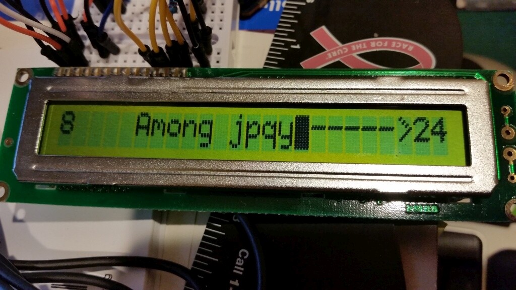

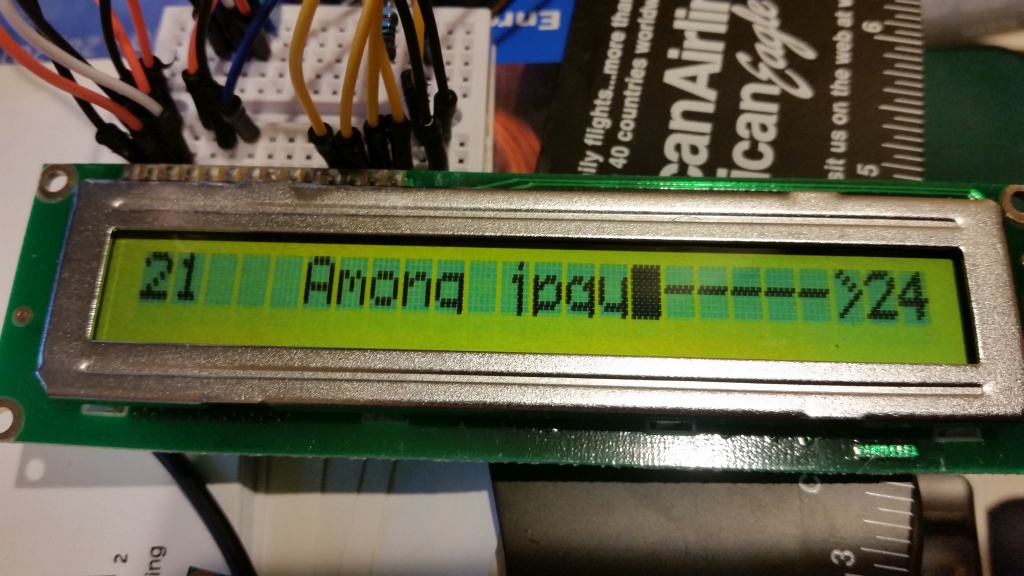

I have included pictures of the cool 1x24 with the 5x10 characters with and without the extra parameter running, as well as the same code running on a standard 1602a 2x16 display with the parameter set.
To make this work, I just used this:
// set up the LCD's number of columns and rows:
lcd.begin(24, 1, 1); // Extra dotsize Parameter here for 5x10 support
lcd.clear();
// Print a message to the LCD.
lcd.print(" Amon");
lcd.write(231);
lcd.print(" ");
lcd.write(234);
lcd.write(240);
lcd.write(241);
lcd.write(249);
lcd.write(255);
lcd.print("----->24");
Thanks again.
