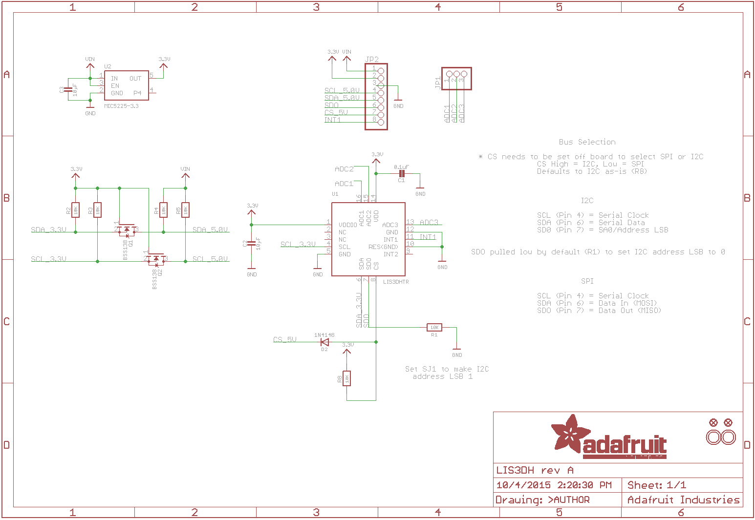

Hi all,
I can't get my Arduino to recognize an LIS3DH sensor on an Adafruit breakout board using I2C connection. All connections are soldered correctly, and connected to the board as follows:
SDA to SDA 21
SCL to SCL 20
VCC to 5V (the Adafruit breakout has a 3.3V regulator and level-shifting to accept 5V)
GND to GND
After several attempts using multiple scanning programs (one, Nick Gammon's, that I will post below) that correctly identified another I2C device of mine (confirming that my Arduino works), I checked the voltage from CS to GND (CS needs to be pulled high to indicate I2C) and found it at 2.4 V, so I soldered it to VCC, and now it reads the same 4.84V.

The address of the sensor is 0x18 / 0x19.
I am lost now and don't have an oscilloscope to troubleshoot I2C. Can anyone identify something I'm missing/haven't checked? What do I do?

CS on that board already has a pullup to 3.3V and you don't need to attach it to anything for I2C operation. In fact, it won't make any difference if you do, unless you pull CS low.
Something else is wrong. Double check your solder joints and wiring connections.
Thanks for the reply!
The solder joints are good, and the connections on the board seem fine. I checked continuity of the following:
SDA wire end-to-end
SCL wire end-to-end (just in case this 22 awg stranded wire separated in the middle or something)
SCL to Drain of Q1 (BSS138)
SCL to R5
R5 to VCC
SDA to Drain of Q2 (BSS138)
SDA to R4
R4 to VCC
and I chased some of the other connections on the board and found nothing I didn't expect based on the schematic (attached).
I don't know where to turn next. Thanks again for your help.
Keith

The module might be defective. Contact Adafruit technical support.
jremington,
Thanks, but I'm not sure if it's defective. I have two other of the same sensors that I tried and they didn't work. I even tried SPI connection with the below code, but to no avail.
