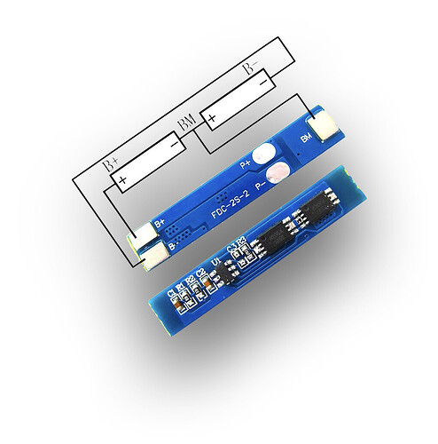

you can find Balanced 2S Chargers
if you need 5V out, you then need to add a buck converter
and how i charge the cells?
You will have to purchase or build a Li charger.
