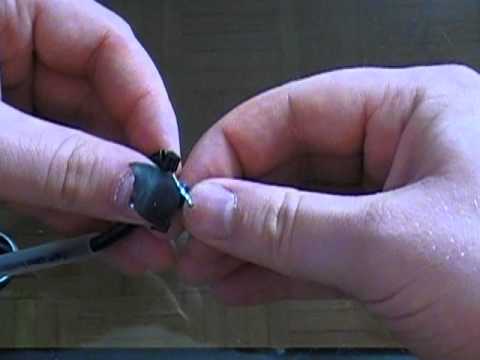

I want to design a system to measure water temperature in tank with lm35 and arduino.As a first step I browse through many tutorial in making lm 35 as water proof one and found one on youtube with following
I tried to sealed my sensors as shown in vedio but instead of plastic case I attached to it copper tube case and started with general code as available on various links.
