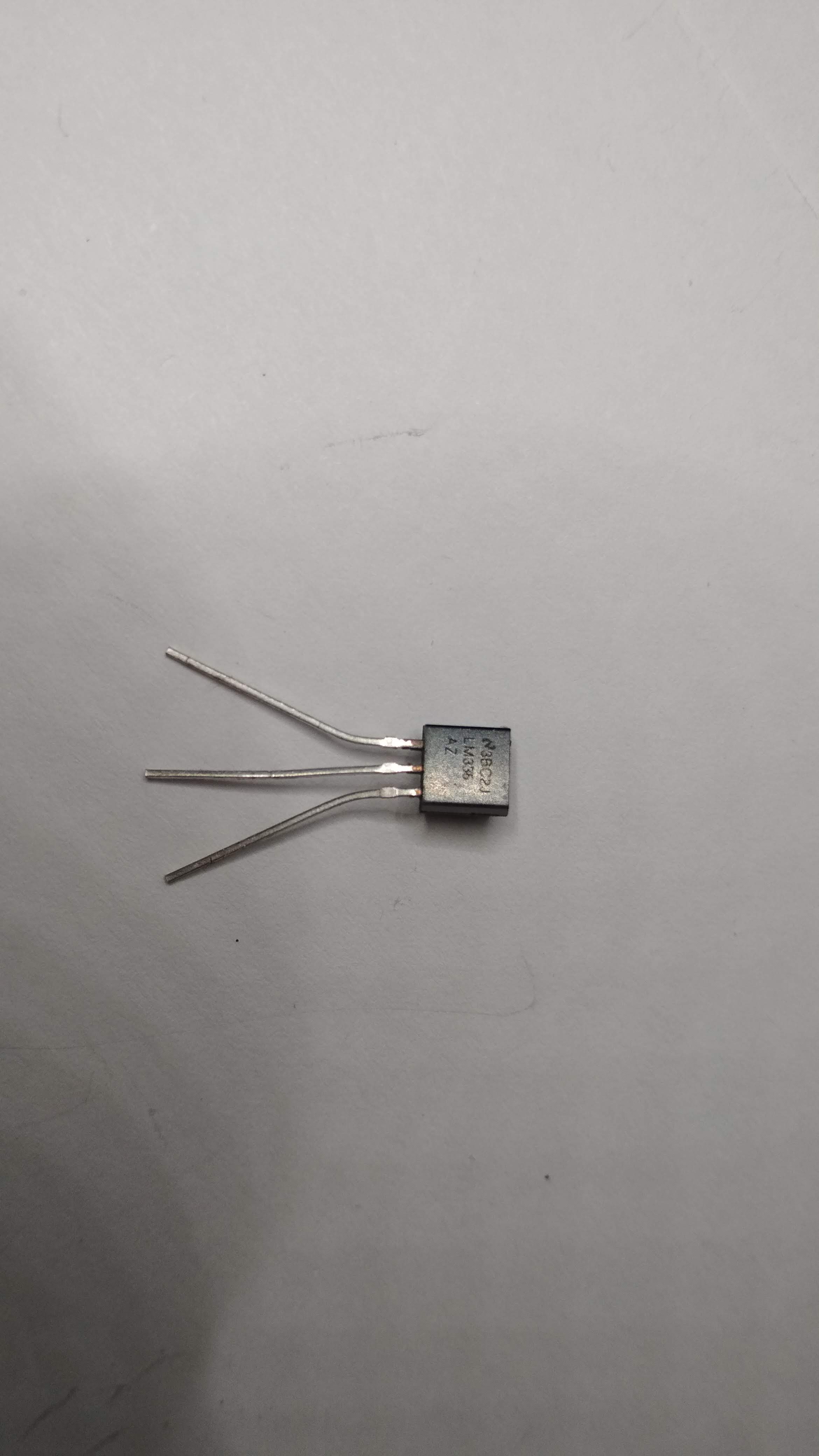

Hi ! I have got 2 times LM335 from 2 different supplyers at AliExpress. Both give me the same electrical values : about 0,75V with 1mA (datasheet 3V).
Fake devices ?

I'm missing the wiring diagram.
Is your wiring like this?
What are the values of V+, R1 and room temperature?

JCA34F:
wiring ok 4V 1K value is about 750mV depending on units with a negative temp coeff (decrease when temp rising) room is about 18°C

You seem to forget that temp result depends on TWO things.
