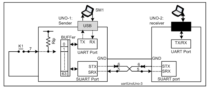

if someone could give me a hand on what should i code to send a temp data from master to slave ..
also, i intend to use a "Compim" to read data via a serial monitor : how exactly can i code that ?

1. Connect your Master-UNO and Slave-UNO using software UART Port (SUART Port) as per Fig-1.
Figure-1:
2. There is no need to connect K1 with UNO-1. Connect your LM35 sensor with UNO-1.
3. Upload the following sketch into UNO-1. (Your one but modified.; compiled and not tested.)

5. Check that SM and LCD of Slave shows the temperature.
thank uu sir , but if i want to use compim for simulation ? because the main project is to commmunicate with 2 xbee , but i dont know how to use it in proteus isis , so i try with compim
