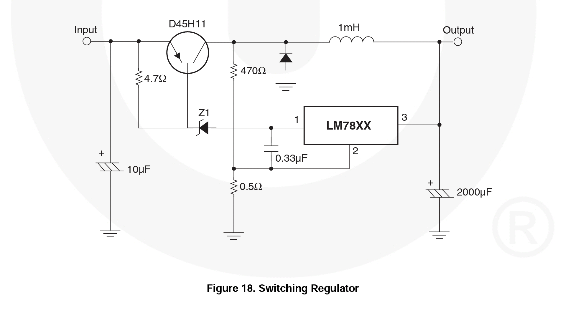

Hi, I'm planning on use a LM7809 voltage regulator to power my arduino project from a 12v engine battery, since I did a exahustive read, the internet recomends switching regulators as they are more efficient, so in the datasheet of the regulator they show a circuit to operate the LM7809 as switching regulator
So my question is about the diodes, can I use any zener and regular or have to be some especifics ones? and the 10 and 2k uF what kind of capacitors are?

Did you look at that circuit.
A lineair regulator converted to a switching regulator.
Looks like a sex change gone wrong.

Why do you need that? Wasn't the Vin pin designed for this exact purpose from the start?
A switching regulator circuit without protection from overcurrent/inductor saturation? Sounds like an expensive
mistake to me.
So the datasheet is wrong about the switching circuit?
Why mis-use a lineair regulator as a (low frequency) switching regulator.
The 1mH/3A toroid and 2000uF cap alone will be 10x the price of a real switching regulator from ebay.
Leo..
a product of Fairchild and National Semi engineers tasked with 'come up with some ideas to Sell this new circuit'.
It works, most of the time.
Makes a better radio jammer than a power supply.
But, also great for killing batteries...
