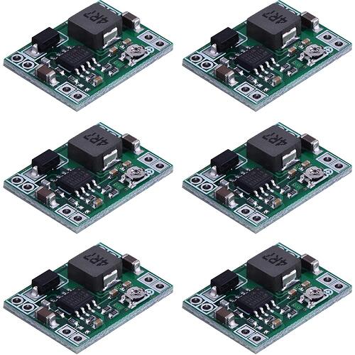

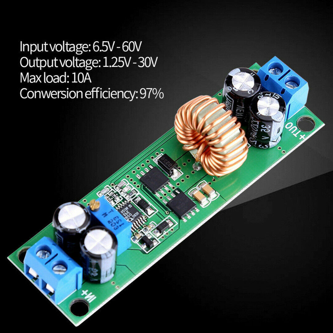

Do you mean something like this:
That looks like the sort of thing but a specification would be a lot more helpful than a pretty picture. And do you really need 10A? That's a lot of current.
Steve
No I don't need 10A.
This one then:
I see some of these buck converters have a usb port, what is the need for that. I only want something to go inside my box with the project, and drop the voltage to 5v from either 9v or 12v.
Thanks
This one might do as people have used for a Raspberry Pi:
