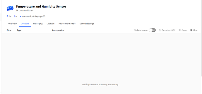

if you go to The Things Network Server and look at the LoRa application can you see the join request and a join accept?
thanks for replying! i'm using arduino pro mini and the sx1276 lora chip.

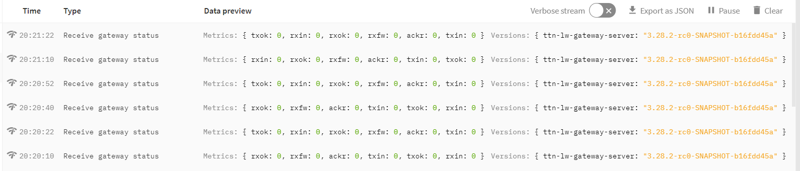

this is the only thing is see for the live data in the gateway.
while there is no connection and live data found for the end device
you are only seeing gateway status - when a join request signal is received it should look like
it looks like the gateway is receiving no signal

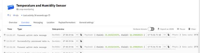

thank you it worked!

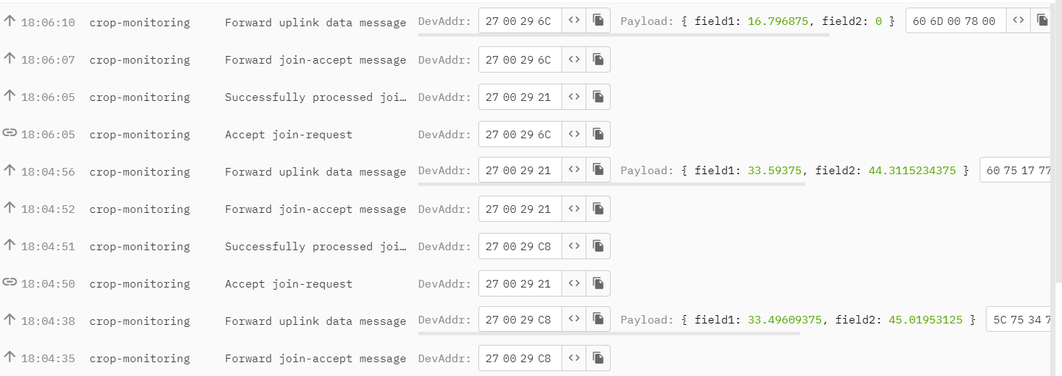

hi! i was able to send packets already to the ttn but it stops after sending 2 payloads. what could be the problem?
is the pro mini still running?
what does its serial monitor show? (upload as text not a screen image)
is the gateway showing any traffic?

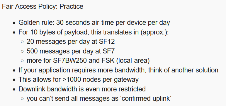

Could well be this bit of code;
const unsigned TX_INTERVAL = 10;
Sending a payload that often might cause issues.
TTN has a fair access policy that limits free use of TTN to 30 seconds of airtime per day.
Try setting the time interval to say 300 seconds.

while this is the payload shown in the console:
i changed it to 30 sec and it worked! thank you so much <33
update: it stopped after the 6th payload
i tried again and it really stops after sending 6 payloads
Thats still a significant breach of the TTN fair access rules.
(if left to run all day)
so i need to set it to at least 5 mins so that i can let it run all day?
Rather depends on how far you are from the Gateway.
As the node gets further away from the Gateway the Spreading Factor (SF) that LoRa uses increases which in turn increases the air time of the packet.
transmitting river level data I transmit 8 bytes every 10 minutes
