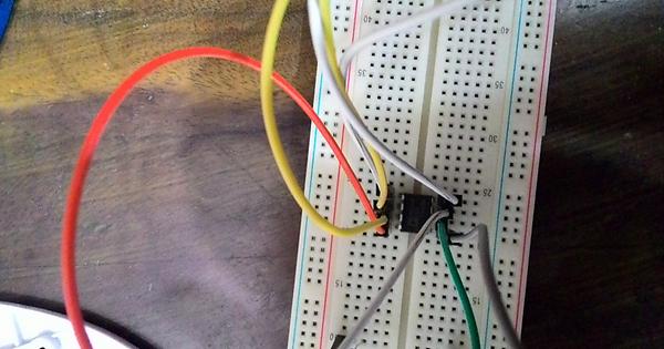

Load Cell and AD620 as amplifier .
I want to make a simple weighting system using arduino (5Kg Max).
I am using this kitchen scale (http://goo.gl/edFeIM) and AD620(http://goo.gl/lwvdt7) as load cell amplifier.
After connecting all the wires , my arduino analog port gives 134 as value . It just fluctuates between 133-134.

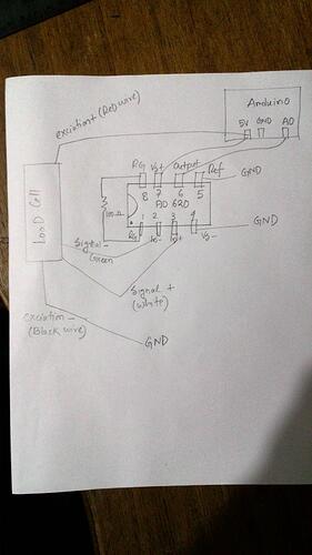

Here is the connection ,
AD620 port 1 & 8 connected using 100ohms .
AD620 2 and 3 is connected to load cell green(signal -) and white(signal +) wires .
Ad620 5 and 4 is grounded.
AD620 6 is connected to arduino analog 0.
Here is diagram of ckt
Here is a demo of the connection
Here is the code i am using

Check how many wires should be coming off pin2 of the IC.
I see one in your picture, but the overlay diagram shows a connection from pin2 to positive rail.
What is pin7 supposed to be connected to?
Which is the correct connections, pin 7 is a supply pin.
Draw the circuit you have in the picture on protoboard.
Then post it for us.
Do you have a DMM to help check voltages around your circuit?.
Where did you get the circuit from, the IC is designed for +5 and -5 supply but the datasheet does show a single 5V circuit.
Tom... :slight_smile:

From pin 2, 1 wire to load cell signal - . Pin 7 is to Arduino 5V .
Here is diagram of my ckt.

It took me a minute to work out too, Tom. On the breadboard, the red wire from pin7 passes underneath the IC and continues to the +ve rail, and the green wire only connects to pin2.
@rdbhaxor, since it's a 4-wire load cell, you probably don't need additional resistors. (See attached diagram, "4 wire load cell")
I might be wrong, but I think it's already a full-bridge.
I'm not too familiar with load cell circuits, but should the op-amp's ref pin be connected to gnd, or to half the supply voltage? Can you post a link to the source of the circuit you copied?
(I just found a circuit, (also attached, "ADC620 Load Cell Circuit"), that indicates that the ref pin should be connected to half the supply voltage and not to ground.)
Mid-voltage if you want to measure force going both directions.
Ground for one-way force, e.g. scales.
Mind the polarity of the Wheatstone :slight_smile: bridge.
If it's wrong, weight will want to go negative.
Output of the AD620 on a single 5volt supply will only swing 2.5-3volt, so only ~500 digital values.
5kg will have 10gram granularity if you have a perfectly stable 5volt rail.
Leo..

Ty for the info. Can u tell me if i have any problem on the ckt ?
After setting the ref ping to 3.3V and the resistance between pin 1& 8 to 100Ohm i am getting good change in analog values.
For no load i am getting 670-671 as analog value
For 218gm i am getting 693-695 as analog value
For 125g i am getting 684-685 as analog value.
Now how to calculate weight from it ?

That's not enough span.
You will have bad resolution.
You should aim for ~250 to ~750.
Subtracting the "zero" reading, and multiplying the remainder, gets the weight you want.
Leo..

First of all thankyou for the help .
My No load Analog value is 671
So i am using this to determine load -
Load = ((x-671)0.204844.7011)
And its working fine But there is error about 5-6 gms . The more load i add the less the error.
I determined the factor 44.7011 from using accurate weights and comparing it with the mv from analog reading.
I sometimes bend the load cell (carefully) untill the "zero" reading is the lowest A/D possible.
Because the datasheet states that the output of the A/D is ~1.1volt minimum, min value will be ~225.
Maybe aim for 250.
Then use a gain resistor so the maximum weight (5kg) is an A/D value of about 750.
Because the datasheet states 3.8volt max (A/D = 778).
Maybe you can mod this sketch I wrote for a pressure sensor.
Leo..
