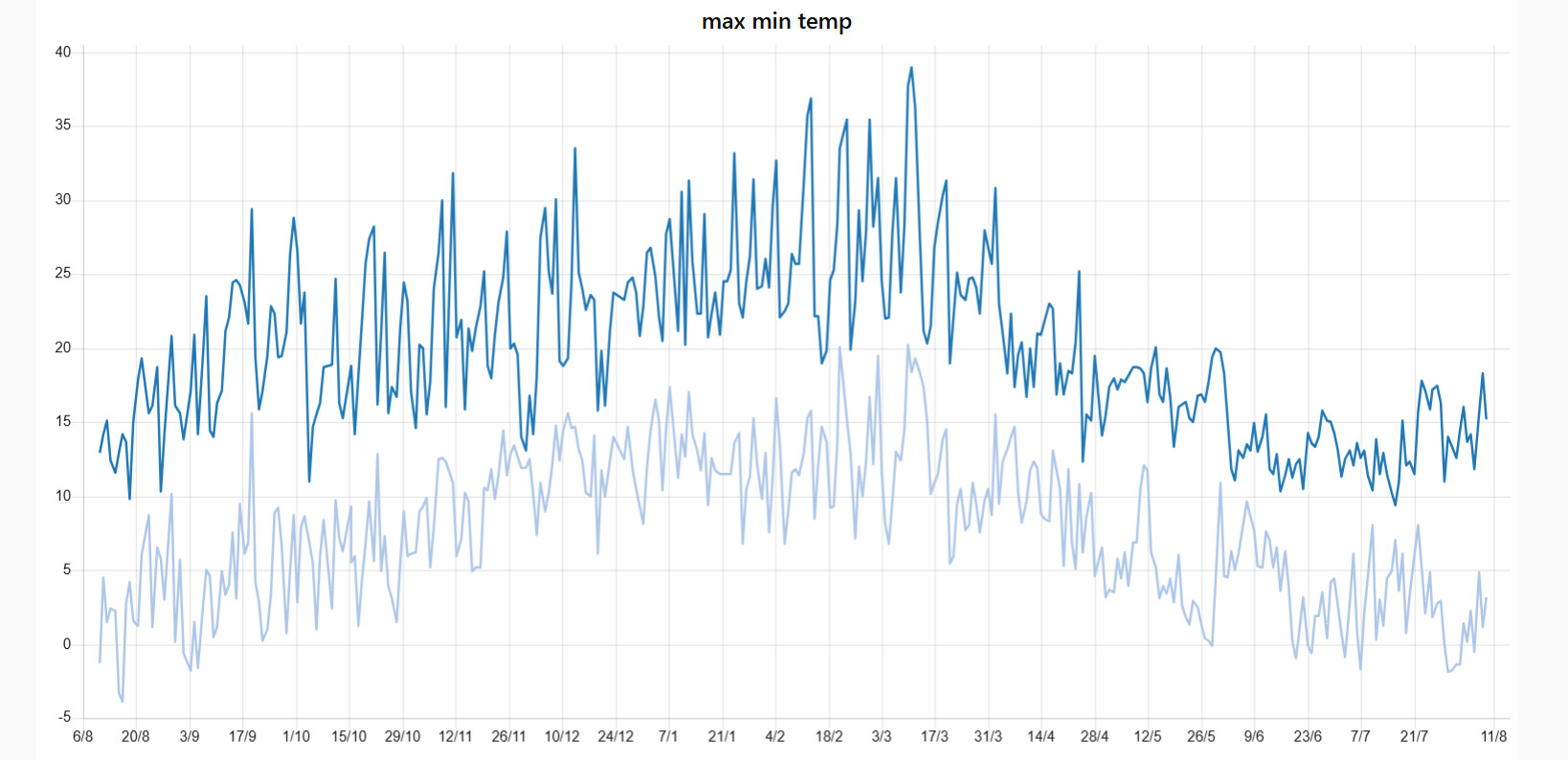

node-red is an excellent way to gather and store your data , it runs on a raspberrypie
its also excellent for displaying your data eg
or this
or
or selectively like this
