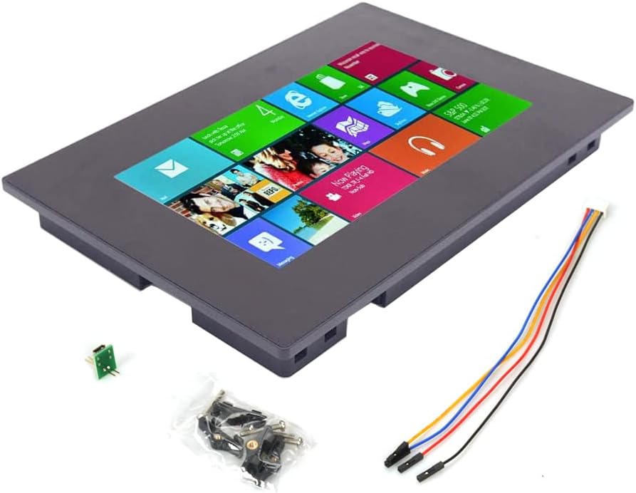

My graphs are displayed on a Nextion display, not a web page. However, the principle is the same, keep the data, draw the graph on demand to display it. My graphs are generated by C code I wrote running on a microcontroller.

My setup does not display on a web page, it displays on a Nextion like this one:
It is connected over a serial port.
