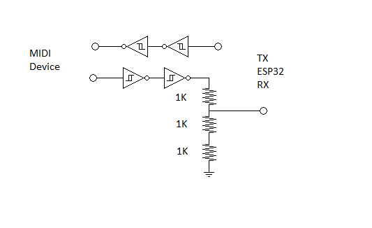

The spec for the output channel is to actually use a Schmitt-trigger (also for Midi Thru) so the best recommendation i can give you would be a 5v powered 74HCT14 and run it thru 2 gates.
The Spec was originally intended for no such clean digital signals and the Schmitt-trigger was meant to correct and square them out better. I use 74HCT04 IC instead and run the signal thru 2 gates. The provided 3.3v logic levels are easily enough to trigger the gate.
As you like. 14 pin though. There must be smaller packages available for something similar through.
On the input side you should just power the Vcc to the Opto-coupler with 3.3v and that will probably do the trick.
What kind of opto-coupler are you using now and with what resistor values ?
There should be no need to actually shift the logic level
That would really be the way to go though. (show us a picture of how gard it is to get to please)
What you could do instead on the input side is use 2 of the remaining gates on the 74HCT14 (or 04) run the signal thru 2 gates, and just use a simple voltage divider made up out of 3x 1K resistors to drop it's logic level down from 5v to 3.3v

Understandably so, for the input it would really be just connecting 3.3v to the pullup of the Opto-coupler, but since you have multi-channel level shifter already you may as well use gates/ports of that.
Does this cover the 5v to 3.3v shifting as well ? I mean from the diagram you posted it doesn't seem to, and ESP32 GPIO pins are not 5v tolerant
Read posts #1 through #8
Ah Ok, i was thinking to aim at a single IC solution for both ways, if required with a simple voltage divider for compactness.
Actually just #8
Hence something like this (using a 74HCT14)
MIDI level shifter
