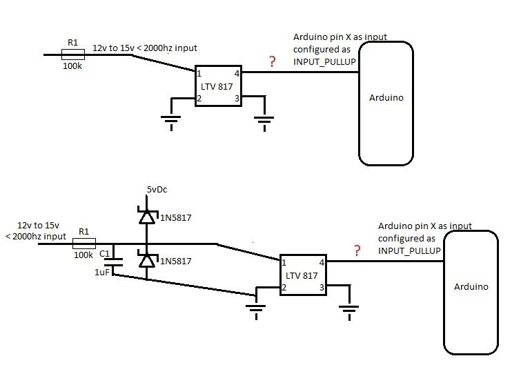

There isn't a whole lot of information resulting from searches I'm doing and I've never used an optocoupler before. Which circuit below (or neither) seem like the best choice and do I need a 10k resistor where the question mark is?
The datasheet can help:
A 10k inline at the ? will not help.
Maybe a 10K from the ? up to 5V per the datasheet would help:
I think the INTERNAL_PULLUP resistance is on the order of 20K-50K, so an external pullup of 1-10K might give better frequency response.

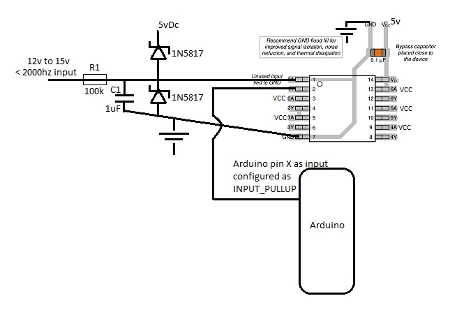

I would use a 74HC14 with a 100K resistor on its input. If powered from 5V the output will be 5V. If noise is a problem you can add maybe 100nf at the input of the gate. This will not load your existing signal as would an optocoupler would and bandwidth way beyond what you need. You can put a second in series with the first if you want a non inverted version of the signal. This uses the input protection diodes. at 50V you will be applying 500uA.

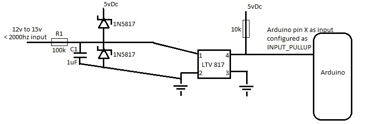

Is this what you had in mind?
rpmCircuit2
Thanks for the datasheet help. How does this look?
Please, learn a bit how to draw schematic and what symbols to use. Resistors look like fuse symbols and grounds on a the pins 2 and 3 look like battery cells... :slight_smile:
1.Optocouplers are used for galvanic isolation, if you want to isolate what you are measuring, from arduino, then pins 2 and 3 shouldn't share a common gnd.
2. R1 (100K) resistance is too high to be able to drive optocouplers LED.
First, think about is galvanic isolation needed?

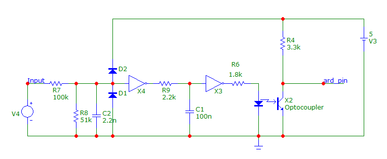

I draw this in MicroCap12, I use for simulation, but any electronics cad software could be used for these simple things..
If you want high input impedance, something like this should be good :

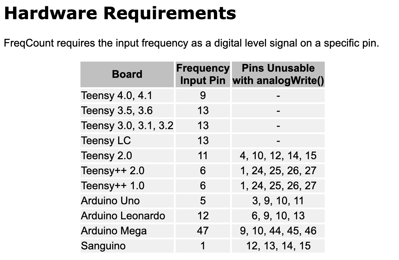

Thanks for that explanation. It appears that FreqMeasure Library, for Measuring Frequencies in the 0.1 to 1000 Hz range, or RPM Tachometer Applications would be best for my needs. Why do I lose pins 6, 7, 8 on my Mega in addition to the measuring pin 49? That seems pretty expensive?
Am I able to generate an output frequency on one pin and input to pin 49?
Pins 6,7,8 will work fine for non-PWM uses, it's that the clock/timer that would normally manage the PWM for those pins will be in use counting your frequency events rather than
counting regular clock cycles.
Pin 47, right? You can use one of the other PWMs associated with one of the other timers to make an output frequency to feed back into pin47.
For freqcount it's pin 47, however for my lower hz readings it seems as if freqmeasure which uses pin 49, is a better choice. Do you agree?
Is there a simple sketch example I can build off of that will allow me to feed out of one pin into pin 49 and print out a frequency?
Ahh, you're right. I thought I the count vs measure comparison document at:
...was the same exact document, and the table at the top was the same. But it is not. On the Mega, FreqMeasure runs the Timer4 counter fast based on a clock, and uses the pin49/ICP4 to InputCaPture the Timer4 count when each cycle happens, versus FreqCount using 47/T5 Timer5 external clock pin to count the number of cycles in a certain interval of time. They are completely different mechanisms and, on the Mega, use different pins (and different timers).
