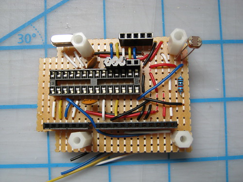

This is the main circuit board. The socket is for the ATmega, the LCD mates with the strip along the bottom (and covers the ATmega), top-right is the LDR:
Some Time Later by funnypolynomial, on Flickr
