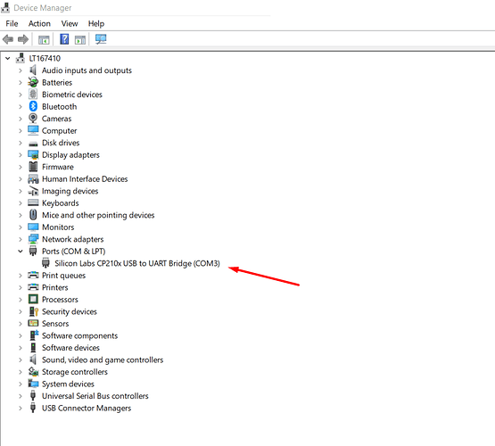

I have check the Device Manager and I can see it under "Other devices":

Did you install the CP2102 driver? As far as I know, it should show up under Ports in Windows device manager.

Indeed! That was the problem.
For other people to know how I solved the problem:
What I have done is to go to the offical page in where are the drivers and installed the one for my OS (in my case Windows 10).
Once the ZIP file is downloaded I have unzip and then right-click to the file named "silabser.inf" and then click on "Install".
Then I connect again the board via USB and it was detected under ports:
After this, Arduino IDE can detect the port and the menu option appears.
