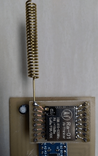

I made one pair of lora with Ra-01 module with arduino nano. As I read in the internet that communication module able to reach 10.000m of distance. But my device just only around 100 mtrs only.
What requirements to my circuit that can reach more 6000 mtrs?

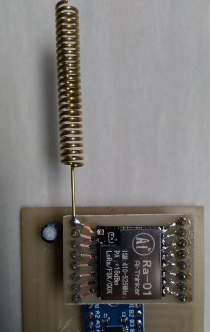

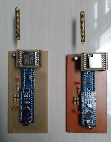

here my circuit, please correct me if I'm wrong
That is presumably with the two modules very close together, that is not very informative.
They should be capable of more distance that that, even though you did not say where the 100M was.
Better antennas would help.
Extreme short range is normally a symptom of faulty modules or antennas, the modules can be damadged if they are operated without antennas, particullary if maximum power is selected.
Of course I test not too close like my photo, it just info about my moduls.
I test the communication with observ the LED1 status. With first modul I placed at home and the second one I carry on the way away from first module I see the LED1 status on second module. And around 100 meters the LED1 is not blinking it mean communication was lost.
With coil antena that I use is can't use for long distance?
bajingan:
Like I said better antennas would help (increase distance) try a plain bit of wire around 17cm long.
However, a range of 100M with the coil antennas is less than expected.
I have never tested the library you are using or the RA-01 modules for range, its possible either is faulty in some way.
I try to add wire that you mention and it's work for around 300 meters.
So maybe I need a good antena for my project.
Do you have any hint for the good antena? So with my Ra-01 I able to reach a few of km?

You can drop the bandwith to 62.5khz will increase range, that shouild work in most circumstances, 41.7khz will work too if you have the gear for measureing the frequency of the modules and making an adjustment.
Increasing the spreading factor to 12 will also increase range.
Setting the coding rate to 8 will also provide a small increase in range.
Yes I test with parameter that you mention and have good result. The distance is increased. Maybe antenna and position are influence factor for distance coverage.
