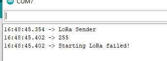

Dunque ho aggiunto il print della variabile e ho questi risultati (in foto)...misà che è colpa del modulo. L'unico dubbio che 0x12 è HEX mentre il numero che mi da indietro è decimale, può voler dire qualcosa?
Lucio
255 è 0xFF ... direi che il modulo o non capisce la domanda o non sta rispondendo e comunque sul bus SPI non arriva nulla (rimane fisso a HIGH per tutti gli 8 bit). :roll_eyes:

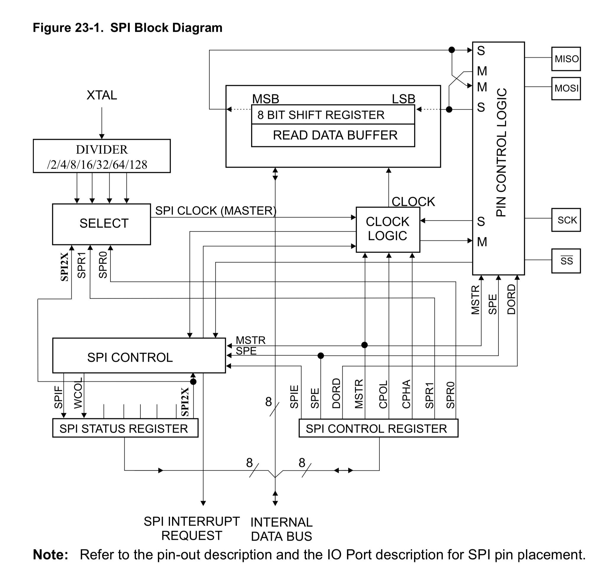

Allora nel datasheet del ATmega328P troviamo:
The interconnection between Master and Slave CPUs with SPI is shown in the figure below. The system consists of two shift registers, and a Master Clock generator. The SPI Master initiates the communication cycle when pulling low the Slave Select SS pin of the desired Slave. Master and Slave prepare the data to be sent in their respective shift Registers, and the Master generates the required clock pulses on the SCK line to interchange data. Data is always shifted from Master to Slave on the Master Out – Slave In, MOSI, line, and from Slave to Master on the Master In – Slave Out, MISO, line. After each data packet, the Master will synchronize the Slave by pulling high the Slave Select, SS, line.
When configured as a Master, the SPI interface has no automatic control of the SS line. This must be handled by user software before communication can start. When this is done, writing a byte to the SPI Data Register starts the SPI clock generator, and the hardware shifts the eight bits into the Slave. After shifting one byte, the SPI clock generator stops, setting the end of Transmission Flag (SPIF). If the SPI Interrupt Enable bit (SPIE) in the SPCR Register is set, an interrupt is requested. The Master may continue to shift the next byte by writing it into SPDR, or signal the end of packet by pulling high the Slave Select, SS line. The last incoming byte will be kept in the Buffer Register for later use.
Non so, ma mi sembra di capire che, quando il ATmega328P fa da master (quindi colloquia con dei devices slave), il pin di SS va gestito dal software dell'utente ... ed io, nelle mie librerie, così ho sempre fatto ... :roll_eyes:
