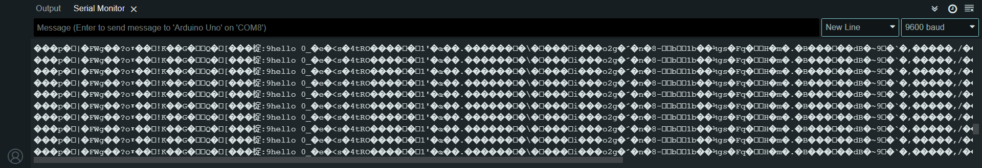

Hello everyone! I am fairly new to Arduino and we are doing a project with the use of LoRa Ra-02 to send and receive specific characters in order for the device to work.
The thing is when the sender sent a message, the receiver just prints in the serial monitor random characters or sometimes not at all. The expected output is that the sender will send the characters 3, 2, 1 based on the measured distance and then the receiver will receive that and perform its functions such as printing on the OLED display and such. However, we can't do it due to the random characters that are sent to the receiver.
Here is the code for the sender and receiver,

In rare cases, we've somehow managed to get our setup to send characters correctly using trial and error methods. We've tried everything from pressing reset buttons to swapping sender and receiver roles. The latest success involved stripping down the components to just the Arduino and LoRa module, using basic code, and once it worked, we gradually add the other components until it worked. However, once we remove the power supply and reassembled everything, it sends random characters or none at all.
Our Arduino board is a knockoff with a CH340G chip, and we're using an HC-SR04 ultrasonic sensor.
Here is the sample picture of what we see on the serial monitor of the receiver:
Please post a link to the product page for the radio module, for the Arduino board, and a wiring diagram of your setup.
The place to start is to get communications working with the simplest possible code, using only the radios, and the serial monitor for input and output.

Are you aware that the LoRa RA-02 module is 3.3V logic and you have connected it directly to a 5V logic level Arduino ?
Its not good to do that, it can cause problems.

We did that as well, and seemed that the devices worked as intended but as we modify the parts and the code, it malfunctions by receiving random characters or sometimes not receiving at all.

based on the wiring diagram that I showed in my reply to @jremington , I am aware that I connect the LoRa RA-02 module in the 3.3 V logic
Wrong.
Connecting the LoRa module to the 3.3V supply on the UNO does not turn the 5V logic level UNOs pins into 3.3V logic level ones.
Also on a lot of UNOs the 3.3V pin cannot supply enough current from the 3.3V pin to supply a LoRa transmitter.
my bad, it is when we strip all down all the components, and back to the basic code. And it seems that the packet data that being sent is still random.
We tested it earlier and record all the print in the serial monitor in the sender as well as the receiver:

Received packet: v0 5' ҙ &h94r״ F i w r r
Received packet: 4r״ F i w r r r n%) 1b M #qHq 1 J m / T b   >)Z $ (P ,+ A B E&ύ _ p G}ciM8.o O|do <AC ͵ wc ٶ ! ܚ/  k*Z? c n £ u z_ 8 NIN w? z ;\ R Wo 7o۠ #K g  Q [ :92r3*/04 <@ v v0 5' ҙ &h94r״ F i w r r r n%) 1b M #qHq 1 J m / T b   >)Z $ (P ,+ A B E&ύ _ p G}ciM8.o O|do <AC ͵ wc ٶ ! ܚ/  k*Z? c n £ uz_ 8 NIN w? z ;\ R Wo 7o۠ #K g  Q [ :92r3*/04 <@ v v0 5' ҙ &h94r״ F i w r r r n%) 1b M #qHq 1 J m / T b   >)Z $ (P ,+ A B E&ύ _ p G}ciM8.o O|do <AC ͵ wc ٶ ! ܚ/  k*Z? c n £ uz_ 8 NIN w? z ;\ R Wo 7o۠ #K g  Q [ :92r3*/04 <@ v v0 5' ҙ &h94r״ F i w r r r n%) `1b M #qHq 1 J m / T b   >)Z
As you can see when we compare the sender and receiver serial monitor output, some of the values are not being sent, and some are printed in random characters. We unplugged it in the power source right after it printed random characters.

To connect 5V logic to 3.3V logic, you can use a level shifter like this one:
However, one or both ends in your experiment may already have been damaged.

A lot of characters there. Odd when the max length of a LoRa packet is 255 characters\bytes.
int packetSize = LoRa.parsePacket();
  if (packetSize) {
    Serial.print("Received packet: ");
Might be worth printing out the packetSize received.
