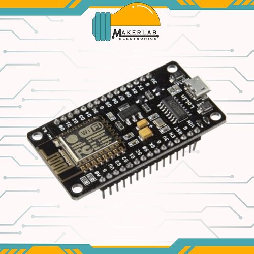

How about this board? Is this okay for the project that I am doing? which includes an ultrasonic sensor, oled, and maybe few LEDs and relays? and LoRa as well

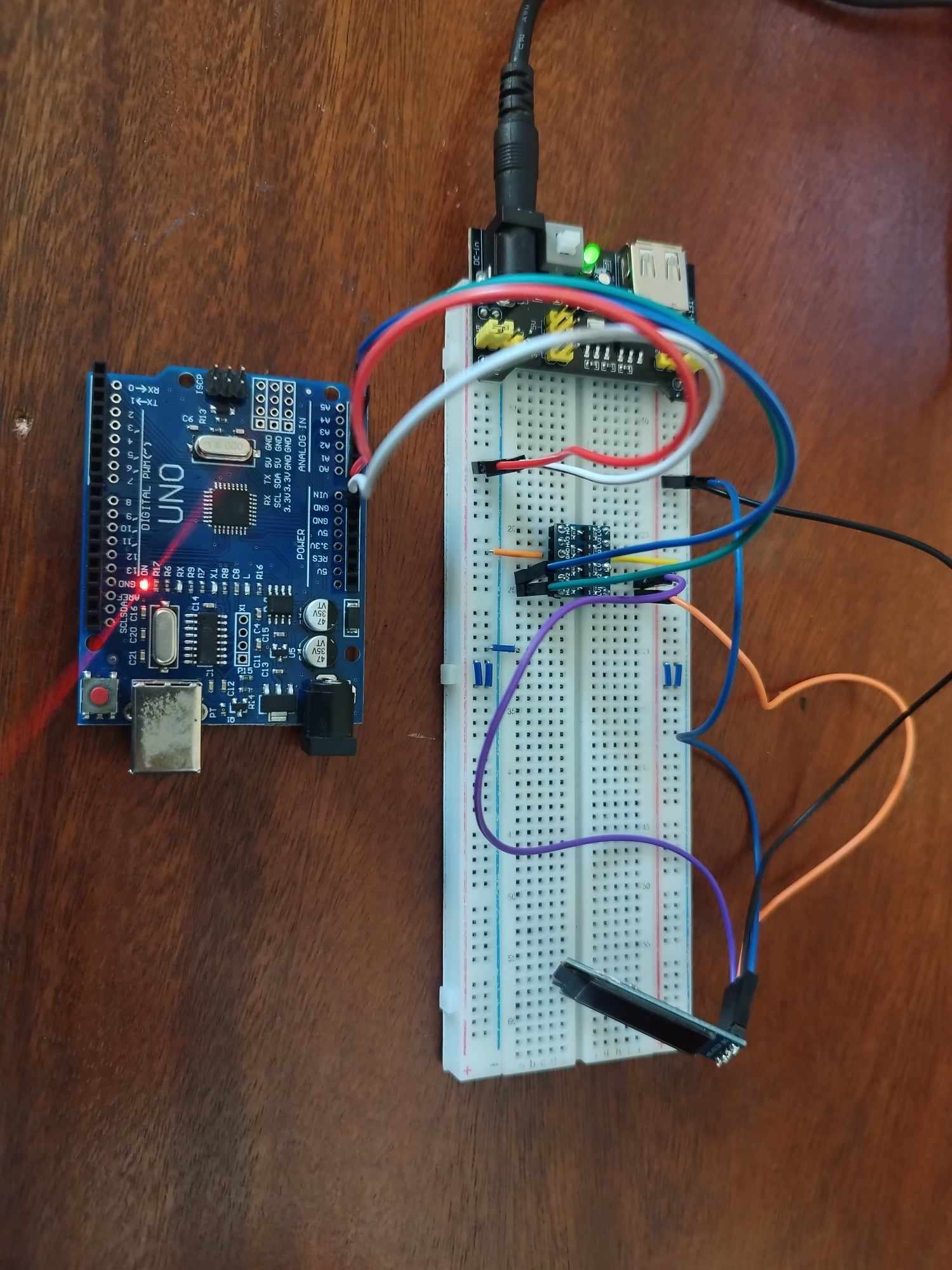

Hello everyone, the products have arrived and we tried to connect it and tested it. What we did was to test the parts individually with a separate power supply:

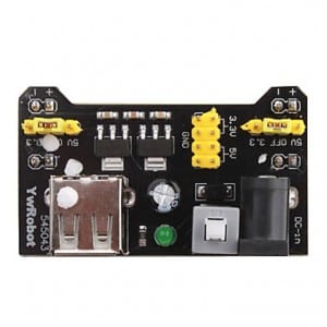

The link provided is the power supply that we use. The ultrasonic and oled works perfectly.
But the LoRa with a logic level shifter and with the said power supply selected in 3.3 v doesn't work. We used the example of the LoRa Library and the serial monitor prints: Starting LoRa failed!
Here is the code for the receiver, we supposed to test the sender as well but seeing that the serial monitor prints it means that there is something wrong with the connection.

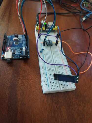

We tried it in the OLED display as well as it can support 3.3 v logic level and nothing is displayed, here is the code that we use:
