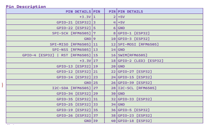

Ok no sorry thats my fault, I made a mistake this is what it outputs
15:42:51.445 -> ets Jul 29 2019 12:21:46
15:42:51.445 ->
15:42:51.445 -> rst:0x8 (TG1WDT_SYS_RESET),boot:0x17 (SPI_FAST_FLASH_BOOT)
15:42:51.491 -> configsip: 0, SPIWP:0xee
15:42:51.491 -> clk_drv:0x00,q_drv:0x00,d_drv:0x00,cs0_drv:0x00,hd_drv:0x00,wp_drv:0x00
15:42:51.491 -> mode:DIO, clock div:1
15:42:51.491 -> load:0x3fff0030,len:1344
15:42:51.491 -> load:0x40078000,len:13964
15:42:51.491 -> load:0x40080400,len:3600
15:42:51.491 -> entry 0x400805f0
15:42:51.631 -> 85_SX127X_LoRa_Device_Check Starting
It outputs this over and over again
So your board is reseting when you start SPI, sounds like a wiring\pin problem .........
I dont have any modules connected to it so I'm guessing its a pin setup problem right? I looked at the documentation and setup the pins in the following way:
#define NSS 13                                   //LoRa device select
#define NRESET 15                               //can be left not connected for this test program
#define SCK 7                                  //for ESP32
#define MISO 11                                 //for ESP32
#define MOSI 12                                 //for ESP32
Here's an image of the pin description in the docs, have I gone wrong somewhere?
When a reference is made to 'pin' numbers, its intended that the GPIO pin number is used.
Your particular board might have the MISO pin as physical pin with a label 11 but you need to know the GPIO number .........
On a ESP32 NodeMCU type microcontroller the normal SPI pins are GPIOs;
#define SCK 14
#define MISO 12
#define MOSI 13
Ahhh okay I see, my bad ill fix that and try again
