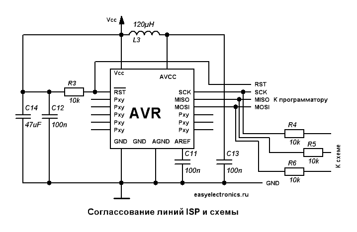

I've found an advice to put 10k resistors on ISP lines when using them, for example for 16x2 LCD at the same time, like this:
What is the reason to have this resistors? What they are protecting?
those resistors are preventing the programming signals from being drowned out by whatever is on the other end of the pins.

Every circuit I've seen has the ISP VCC pin connected to the target VCC.
As for the above circuit, it should work unless some application is actively driving MISO, in which case it will override the programmer's signal.
Also, there is a remote chance that the programming signals may affect the other logic on MOSI and SCK.
