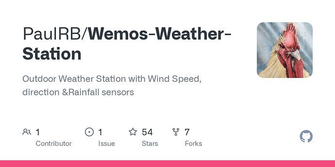

I am developing a low power weather station. At the moment it consumes around 15mA, but I have some ideas to reduce this to less than 1mA.

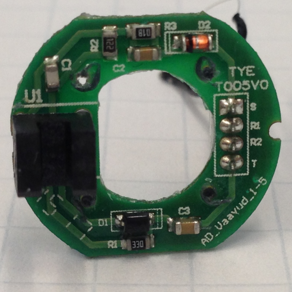

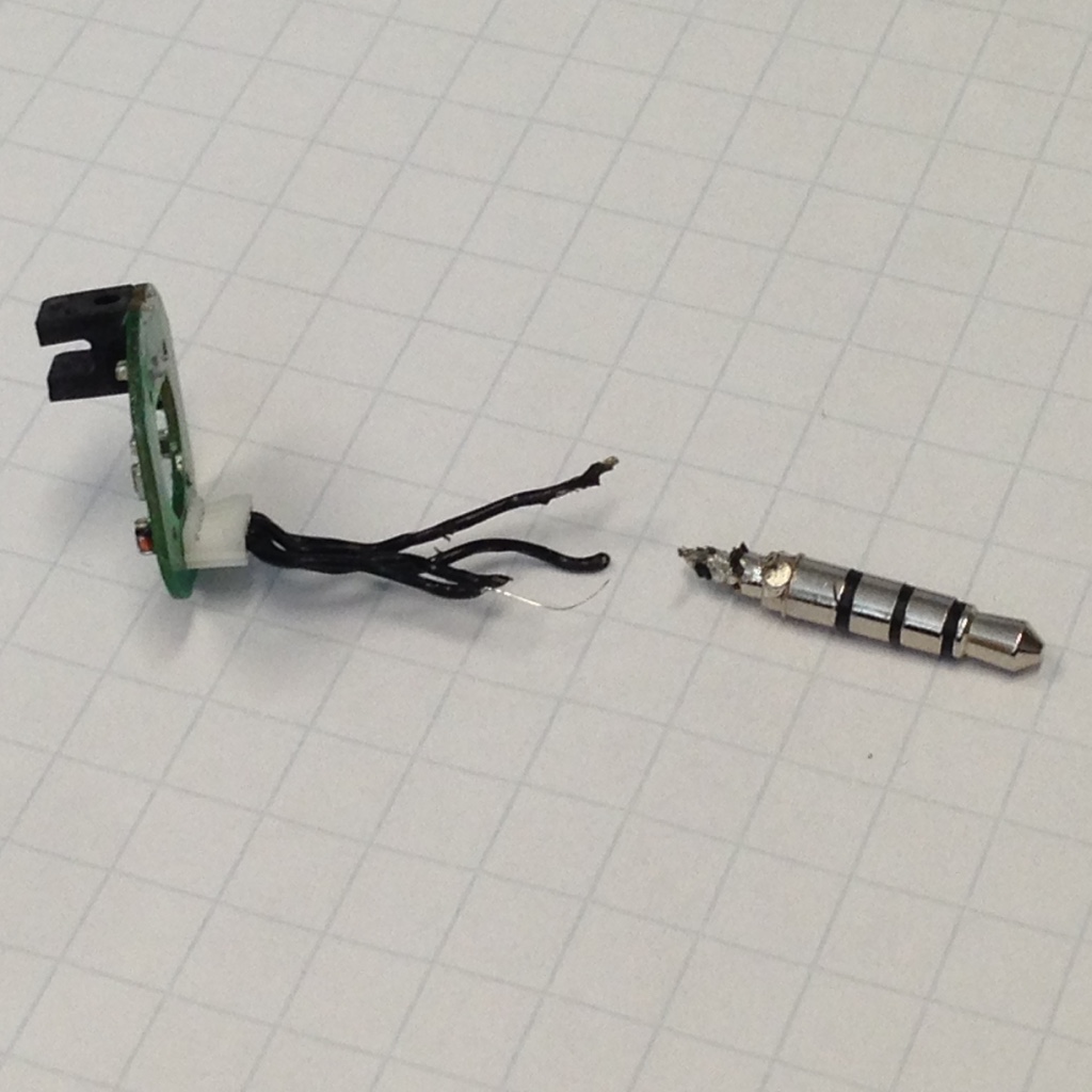

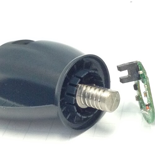

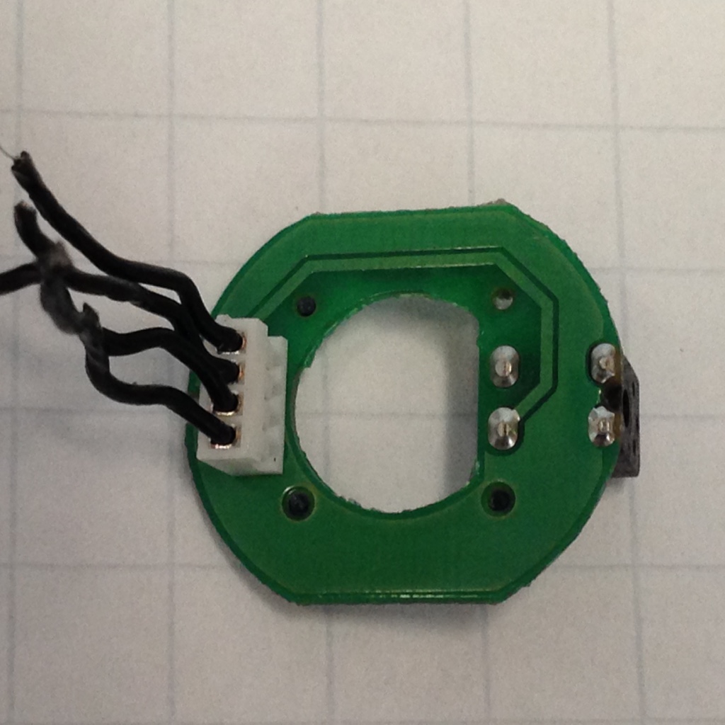

@DrDiettrich The DOF idea sounds great. It can be used both in monitoring wind direction and wind speed. One thing bothers me is that how to prevent the twisted wires since these sensors will be mounted on a spinning object. I also attached some pictures from opening up the device from Vaavud.com. It seems it uses the concept you mentioned. I wish I can just get the readings out on Arduino, because it is the right size not to be noticed by human or animals.

In img 9712 you can see the light barrier (black U shaped), that separates the rotating slits from the stationary circuit.

The weather station updates the database on the web server every 15 mins. But it cannot go into deep sleep between these times, like my indoor temp/humidity sensors do, because the wind speed, direction and rain sensors need to be constantly monitored otherwise events would be missed. So the ESP chip goes into modem sleep instead, hence the 15mA consumption, where the CPU remains active but the WiFi modem powers down.
I hope to use an attiny84/85 to monitor the sensors so that the ESP chip can go into deep sleep. Communication between the two chips is preventing me from doing this at the moment. I want to use i2c to connect them together but I have not been able to make this work reliably so far.
