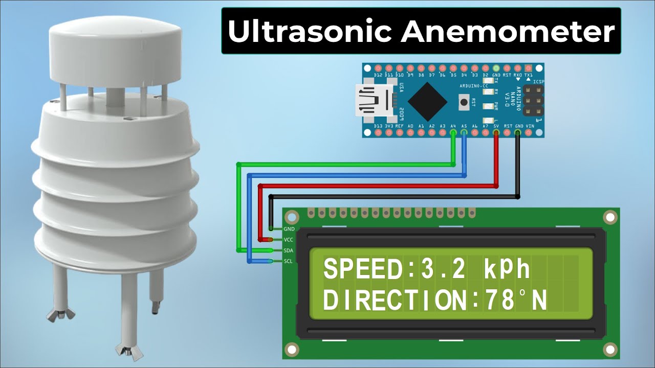

That looks like an ultrasonic wind speed/direction sensor. These are quite expensive. Most Arduino-based weather projects use more conventional 3-cup anemometers and wind vanes.
The 3-cup anemometers mostly have with either a small motor or a rotating magnet and reed switch. The motor type generate a small voltage which the Arduino can measure. Higher voltage means higher windspeed. The magnet/reed switch type generate pulses which the Arduino can count over a fixed period. More pulses means higher windspeed. These types can be very low power consumption.
More expensive types of anemometer have a hall-effect sensor, which requires a little more power to run. Other types have a microcontroller built in which measures the windspeed and communicates this to the Arduino using RS485 or CANBUS interfaces. These types require more power to run.
