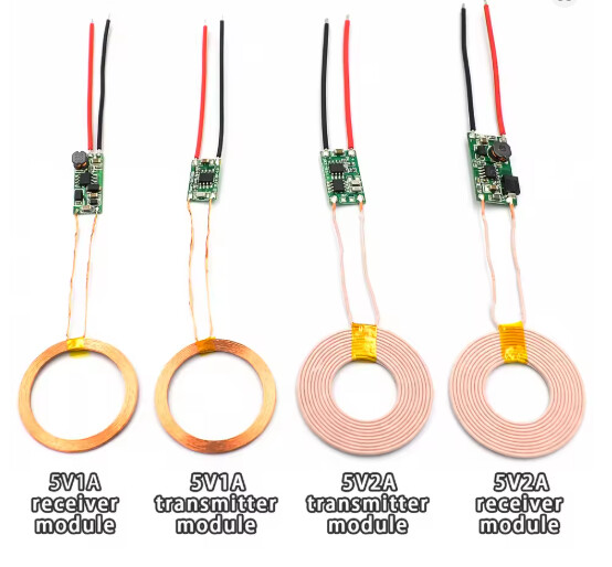

To power an external module use these products.
If it is made of non-metallic material, you can use inductors to pass energy from one side of it to the other side such as these below.
5V 1A/2A Wireless Power Supply Module Charger Transmitter Receiver Terminal Circuit Board”
And passing data over wireless :thinking: that’s actually brilliant.
But I need flat surface on both sides to fit the transmitter and receiver!
Unfortunately there is no space for it in my bumper.

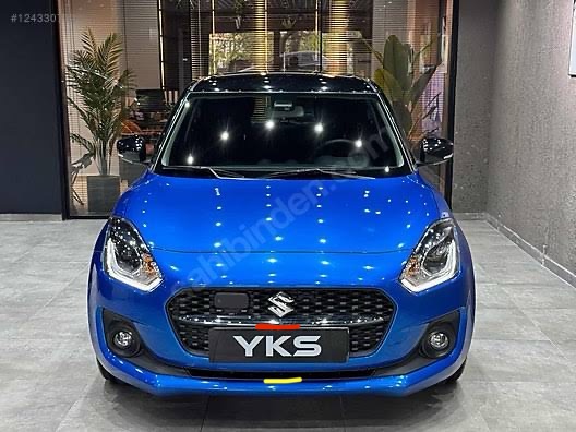

I was thinking of putting the device on the upper side of the plate, then I noticed the Radar is near it, and I guess it will make some problems if I used radio waves.
So I guess best option is to put it where the yellow line is, and make it wired.
I don’t need to make holes in this way!

I see dozens of holes the wires could pass through in the car pictured. I would likely come through the grill behind the license plate mount. the sensor itself could be mounted using the 3m double sided tape that is used for mounting emblems.
Actually I would mount the sensor behind the grill pointing through one of the holes in the grill so it would not be noticeable.
After checking, you’re absolutely right…
I didn’t notice these bottom holes :smiling_face_with_tear:

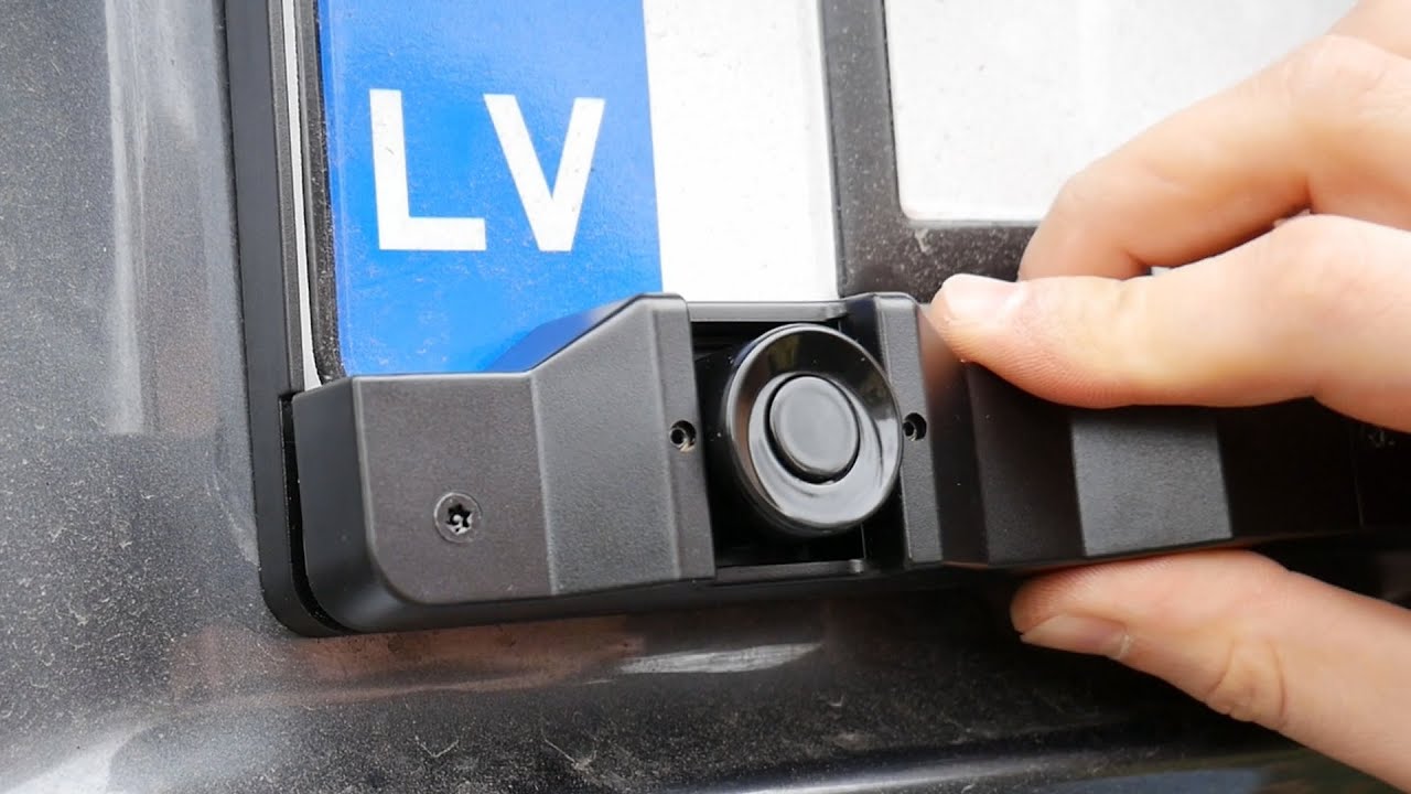

I will just buy this kit, and only install one sensor, no need for custom build
Then I will print something to make the sesnor fit perfectly
Thanks dude
Much better plan. But I would use at least 2 sensors those automotive sensors have a very narrow range ( 15° i believe)

Those are Automotive sensors. They are typically mounted in the face of the bumper and are practically indestructible.
I pushed one through its mount with my finger.
