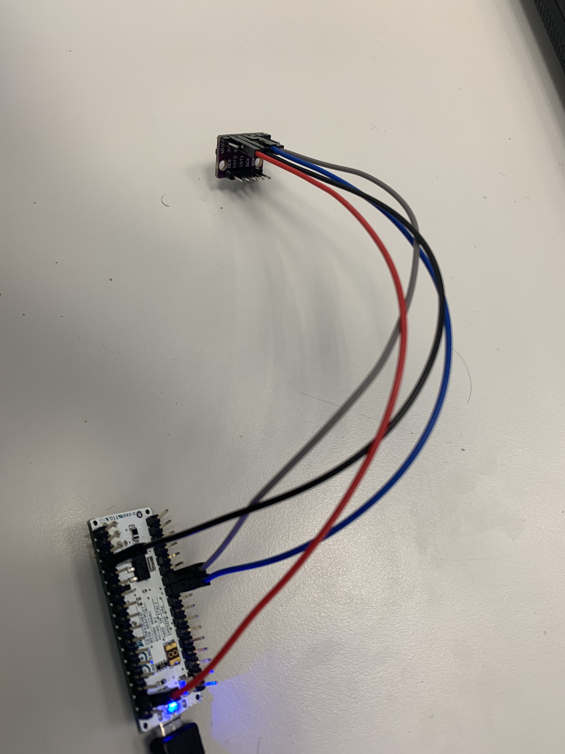

I try to ready data, using I2C,from my sensor LSM6DS3 but I can not ready them. I connected my Arduino micro 2 and 3 to SDA and SCL. I dont know why data doesn't change.
I also try to find I2C address but on 0x69 and 0x6B (for both of my sensors) it sill read the same values.

this is when I try to find i2C address:
so. only one sensor is present. LSM6DS3 on 0x6b not found.
I only use the LSM6DS3 as you can see on this pic.

this is definitely not SparkFun module.you must write address while initialization like
LSM6DS3 myIMU( I2C_MODE, 0x69 );
Yes i already try this one. It doesn’t work.
I don’t understand, maybe a connexion / sodering issue?
if scaner see the address then well connected. try scaner without module
I tried too. It found nothing. Do you think It is because that the baud rate isn’t the same as the spark’ module?
no. i think this module is counterfeit.
there is no solution to connect this sensor? I need this one for my job.
