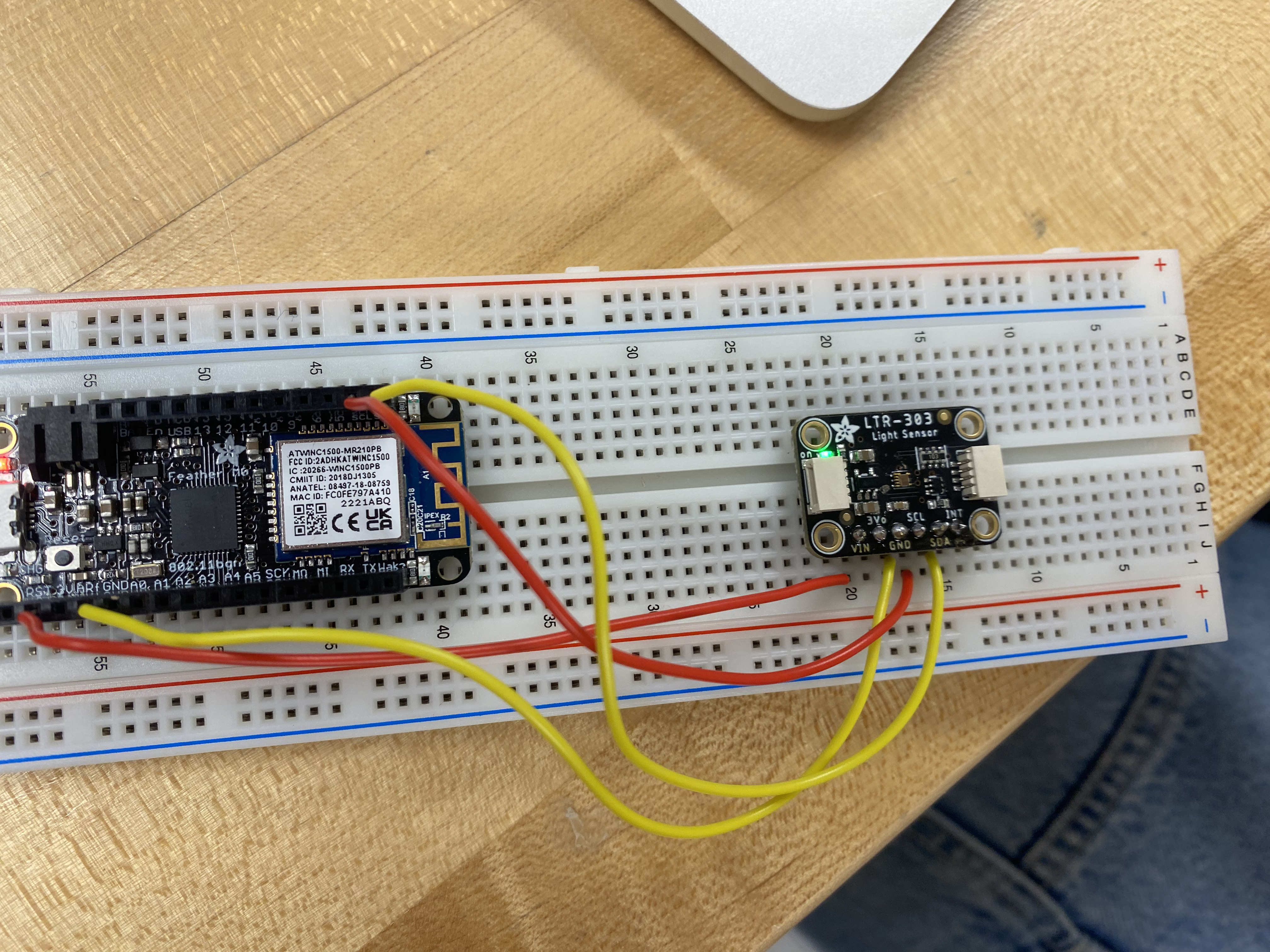

Dear Arduino Forum,
I am trying to utilize the LTR-303 sensor to help me create a device to trigger a pin interrupt when 5-30Hz frequency is detected. I have edited the advanced code to receive an output of visible light intensity in Lux but I am having trouble figuring out how to convert this value to frequency. Below is the link to the sensor.
5610 Adafruit Industries LLC | Development Boards, Kits, Programmers | DigiKey)
Here is the code I have been working with, I would appreciate any help with finding out how to utilize the code and sensor I have to get these values for me.

Breadboard setup:
What has led you to think the device is able to create an interrupt based on frequency of something? Yes, I downloaded the data sheet PDF.
Please use code tags when posting code (you can edit your post).
Your code will need to measure the frequency and make decisions, and you will probably find that the LTR-303 is unsuitable for measurements of rapidly varying light levels, as it is an integrating sensor with a minimum sample period of 50 ms (not counting the time required to transfer the data to the Arduino).
A photodiode or phototransistor would be a better choice.
You should abandon the LTR-303 and use a plain photo transistor as an input. The LTR-303 is not capable of sensing the frequencies you desire.

In your previous post on this same topic, several forum members pointed out that the LTR-303 is not suitable for the project as it cannot do what you want.
@photoepileptic, please do not cross-post. Threads merged.
