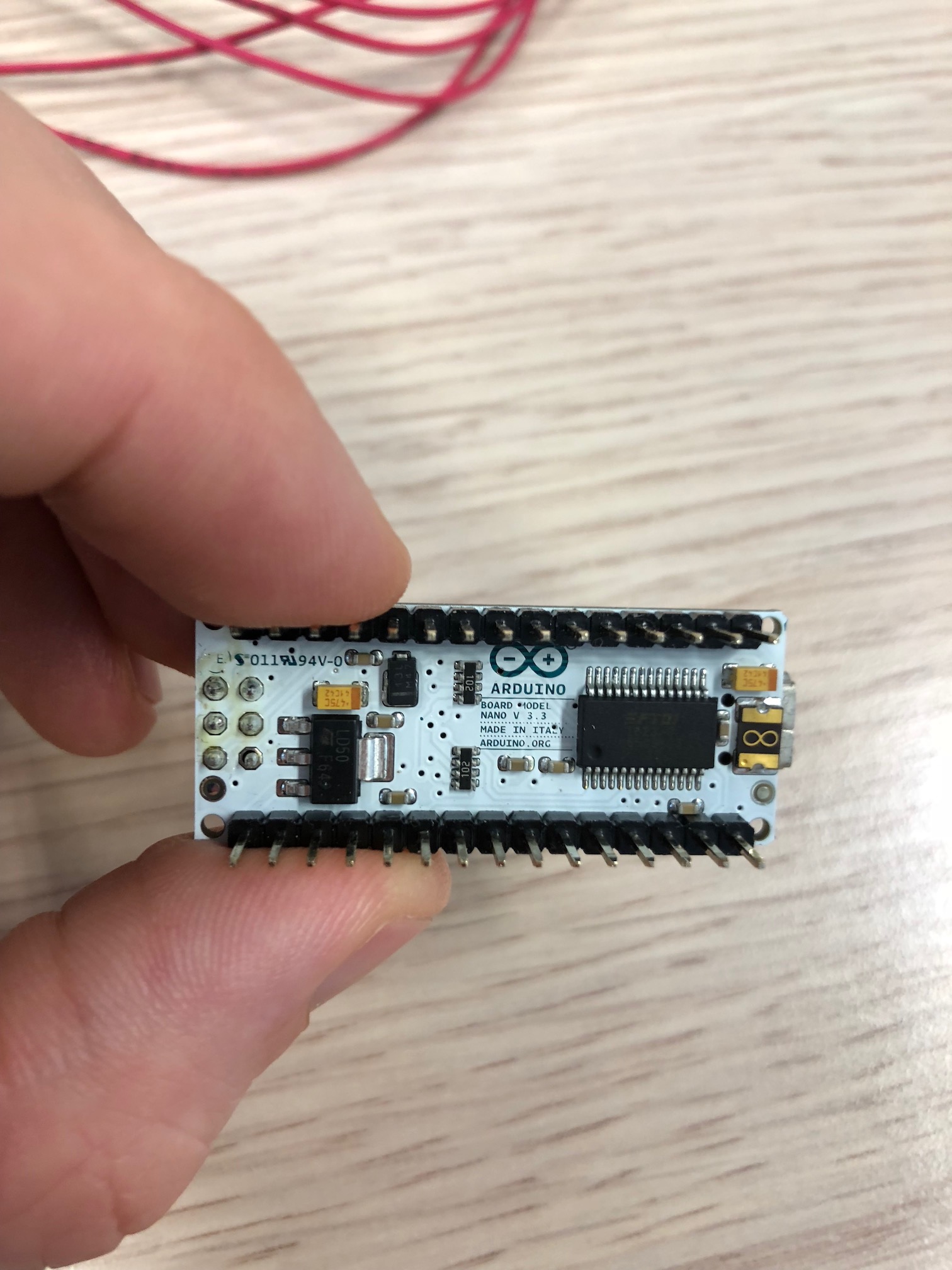

When I plug my Arduino NANO (v3.3), no serial ports show on my mac.
  • Arduino NANO is genuine, no chinese copy
  • MacBook Pro with Touchbar, USB-C ports. I use the mac adaptor USB-C -> USB-B
  • MacOS High Sierra 10.13.4 (17E202)

I realized that the MacBook detects the Arduino when I plug it, like this (see attachment)
Hm, for some reason, this worked: GitHub - adrianmihalko/ch340g-ch34g-ch34x-mac-os-x-driver: CH340G CH34G CH34X Mac OS X driver
Although my Arduino is original, not a copy! It doesn't make sense ... puzzled face

How do you know your Arduino is "original"?
By it's looks ... or am I being too naïve that it reads "made in Italy"?
Sorry, but yes .. here in Peru every chinese copy of the UNO says made in Italy. It isn't enough guarantee always. Strange, indeed, that you needed the driver for the original, id it really is.
