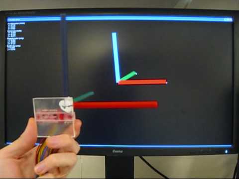

That's it, i am going to use this magnetometer for Multicopter to know where we are heading, so the magnetometer is not always flat, steady, and parallel to the ground. And the problem is the magnetometer need to be held flat to function properly. If we tilt it (pitch or roll) to certain angle (for example to 45 degrees) the reading will be more inaccurate the further the compass is tilted. So I need to keep the accuracy of magnetometer even we tilt it.
I am looking for some references on the internet and found some useful sites like this (Maybe it will help explain my problem more clearly): https://www.loveelectronics.co.uk/Tutorials/13/tilt-compensated-compass-arduino-tutorial http://diy.powet.eu/2011/03/19/tilt-compensation-azimuth-pitch-le-roll/?lang=en https://gist.github.com/timtrueman/322555 http://n0m1.com/2012/02/27/6dof-arduino-compass-accelerometer/
They are says we need both accelerometer and magnetometer to solve magnetometer inaccurate problem when it tilted, and use an algorithm. But, i still not yet success to solve this problem.
Thats not really correct. That is spurious wooly thinking which comes from the days of 2-axis magnetometers, maybe. A 3-axis magnetometer DOES NOT need to be held flat to function properly. It is always going to correctly show you the direction of the geomagnetic field ( or any other magnetic field which is present ), relative to its own current orientation. Apart from scaling and offset calibration for the different axial directions ( which will be an issue whether you are holding it flat and level, or not ), the assertion that the reading will be more inaccurate the further the compass is tilted, is simply not correct.
If you know the orientation of the device, you can always determine the projection of the magnetic field vector into a plane parallel to the ground. If you don't know the orientation of the device, you can compare the measured magnetic field vector to the expected magnetic field vector in your region, to determine the correct which needs to be made to the modelled orientation of the device.

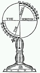

The direction of the magnetism is flat at the equator, and pointing down at the poles. http://geokov.com/education/magnetic-declination-inclination.aspx http://en.wikipedia.org/wiki/Magnetic_dip This site tells how much the inclination is, http://magnetic-declination.com/ (if you type your location, click on the location marker). This site tells even more, http://www.geomag.bgs.ac.uk/data_service/models_compass/wmm_calc.html (click on the map to place the marker).

Oh, and i found this video: http://www.youtube.com/watch?v=fOSTOnQzZCI
i look up for his code and he use something called Quaternion..
Yeah, quaternions are the way to go.
