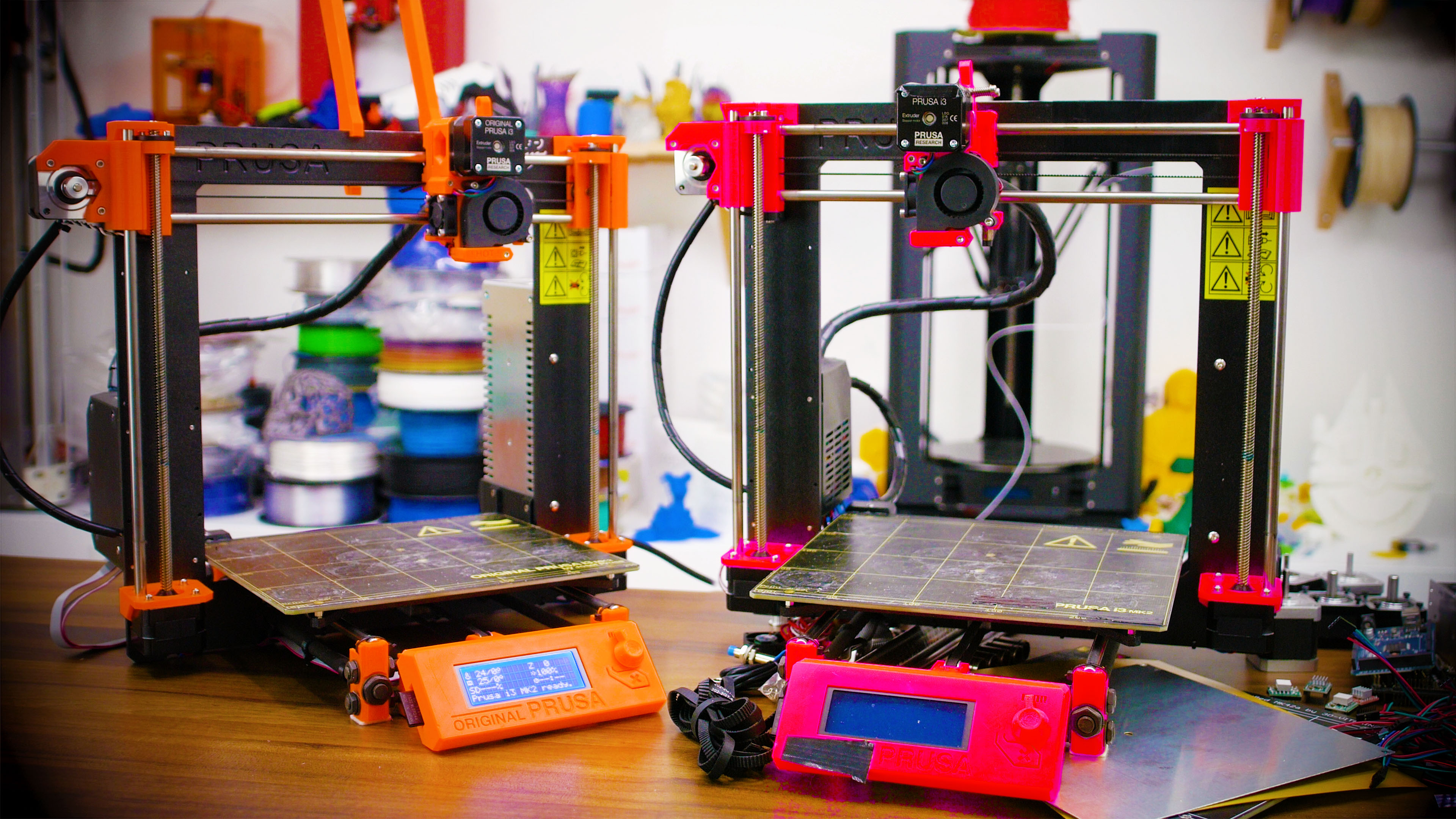

Thomas Sanladerer made one based on the Prusa i3's design (probably the best known reprap).
Here's his BOM:
And the assembly:
Here's his BOM:
https://toms3d.org/2017/02/23/building-cheapest-possible-prusa-i3-mk2/
And the assembly:
https://www.youtube.com/playlist?list=PLDJMid0lOOYkdh8jCqIw7AFIHQiuKbSKZ
Benjamin Heckendorn also made cool videos on The Ben Heck Show about building your own printer.
