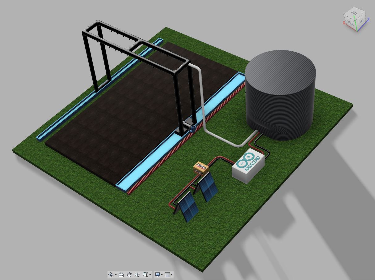

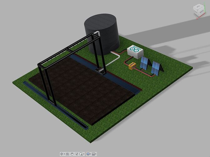

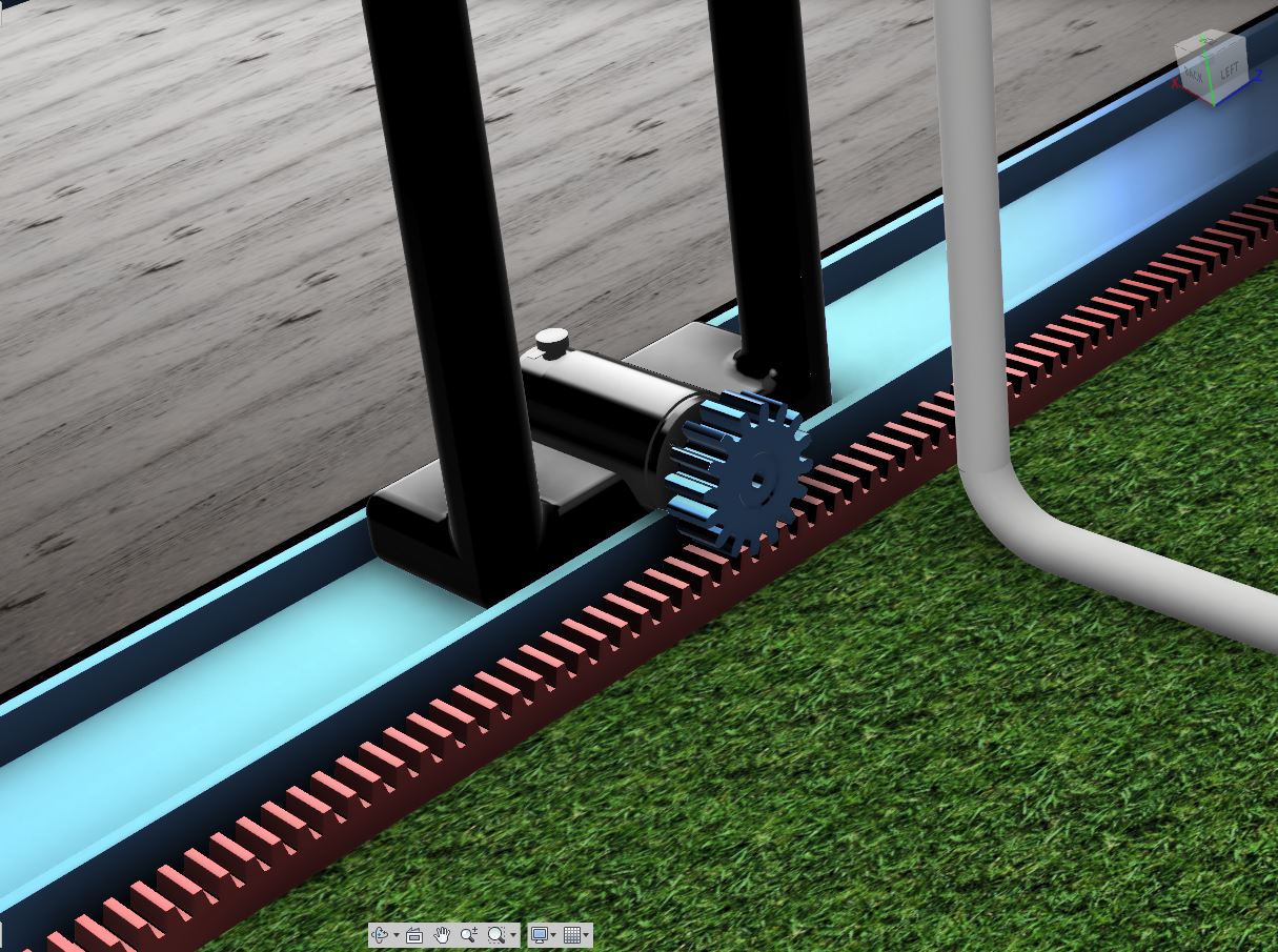

I have decided to make a plant watering system for my yr 12 major project, it will be using sensors in the soil to give readings which will activate a pump (this bit I have done before) however the challenging bit is that I have added a "moving" shower over the top that will use a 10rpm motor along a fixed rack to move its way along. My question is how do I get it to run from external power? and how do I set parameters? (e.g. not going off the end of the rack).
I have attached some photos of my first prototype from Fusion 360.
Cheers in advance
Here's the OP's pics.
To run a dc motor off external power (by which I assume you mean, not from the Arduino 5V) you need some kind of driver module like one of these, chosen to suit the motor's voltage and current requirements.
A dc motor's probably not going to be controllable reliably by "parameters", where you might eg run it 10 seconds each way. So you might want to put encoders on, so you can count how many revs it did, or opt for a stepper motor.
Or you can rig limit switches at the ends of the travel, so when the motor nudges the switch, or maybe do it optically or magnetically, Arduino senses that the motor has arrived and reverses direction.
I would add an encoder, so you not only know how far you moved, but also whether you're moving at all (or that there's an obstruction along the path).
Limit switches are a must, at least on one side, so you can know where you are when the module starts up (if not triggered already, move slowly one way until you trigger the limit switch).
You may consider a stepper motor for this for better control (no need for an encoder in that case).
I notice you have solar panels in the diagram. I have a very small solar powered plant watering system that has a rechargeable battery. Initially I assumed the panel would keep the battery topped up, but that is not how it works. Instead the amount of sun determines how much charge is put in the battery and that in turn determines how much water is pumped i.e. rather than being fully charged most of the time the battery is flat most of the time.
Anyway I know this is deviating from your question but as well as using sensors in the soil to measure moisture you might want to also measure the amount of sunlight. That would give a cross check on the soil sensors which might give patchy readings. Also you might want to avoid evaporation loss by not watering when the sun is strong.
Is there any reason you are going for a moving gantry rather than surface or sub-surface pipes?

the rack is a poor mechanical choice as anything can fall into it and it will collect debris and water. works fine for the theoretical. chain drive on the overhead, the chain lays on the rail so that it does not move. fixed at both ends.

Your water pipe won't work as drawn. That doesn't let the gantry move. Managing the length of pipe is going to be a big part of getting the project to work in the real world. I used to work on machines with tracks that were kilometers long and the segment of the machine which managed the electrical cables was the most expensive part. Even short hoses and cables don't always work the way you expect without some effort managing them.

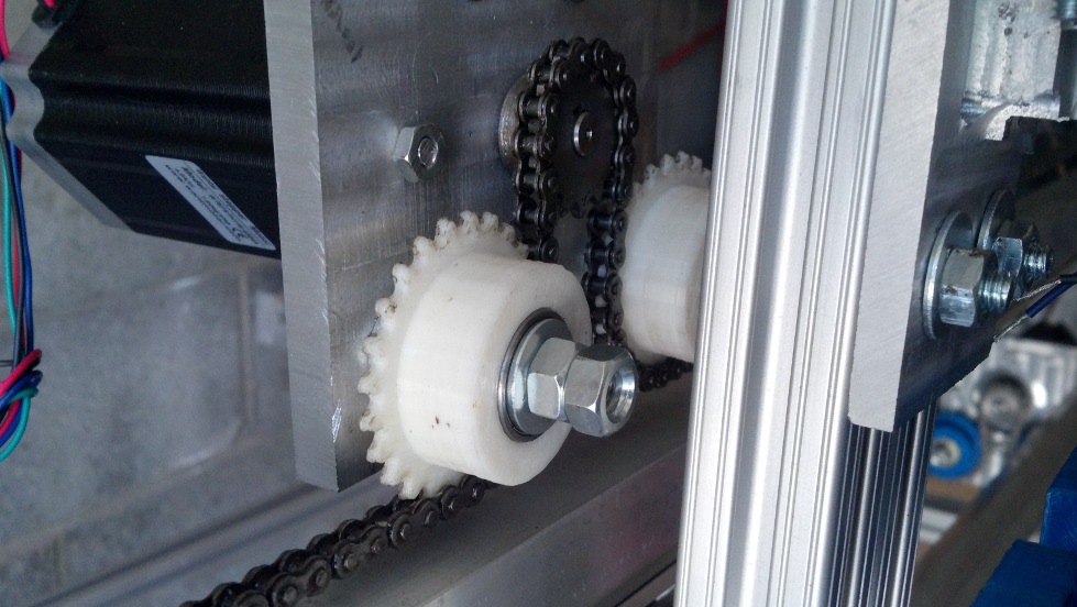

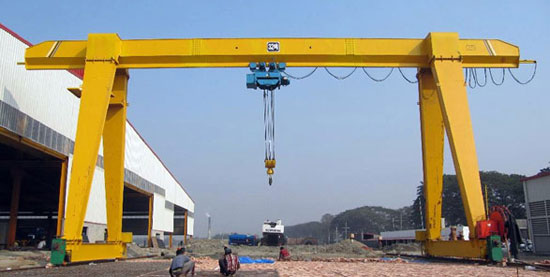

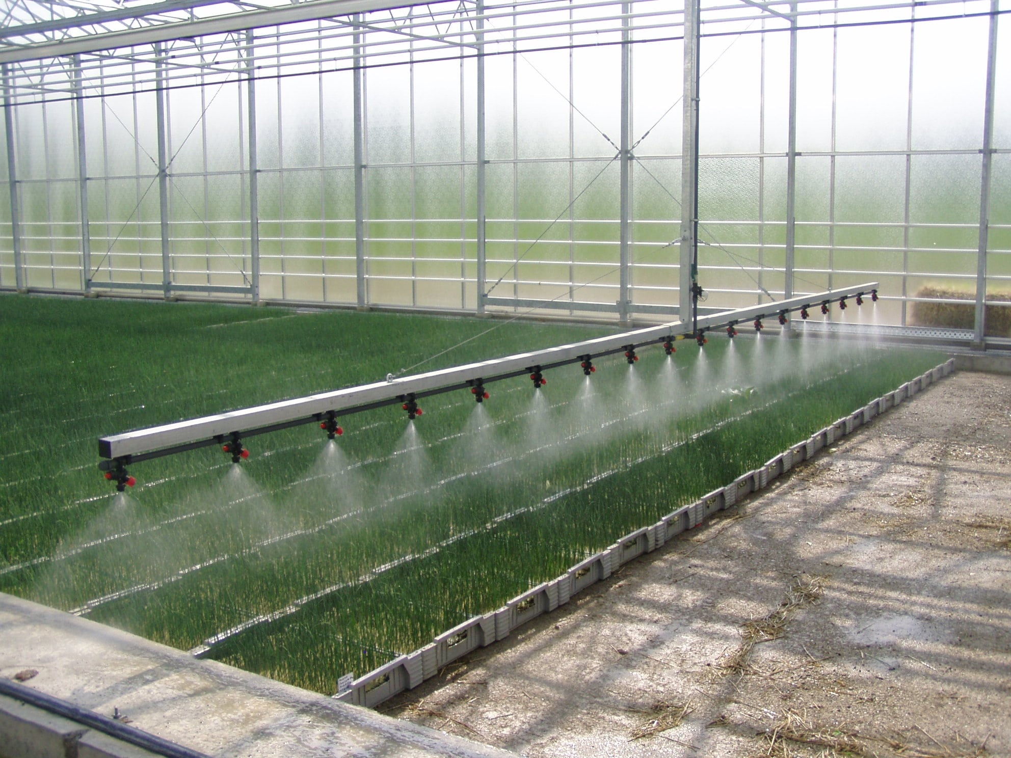

Do you think something like this would work, kinda the way a 3d printer works except only on 2 axis?
TheShaggyWhale:
Nice image - but how is that sprinkler bar suspended? I can vaguely make up a single wire - which is not enough for proper control - and not at all the water supply.
wvmarle:
I would have to modify it to work, however, do you think it will be better than the rack and pinion idea by having a single or 2 axis system?
Not knowing how the think in the image you posted works, I have no idea how you plan on modifying it nor whether it could work.

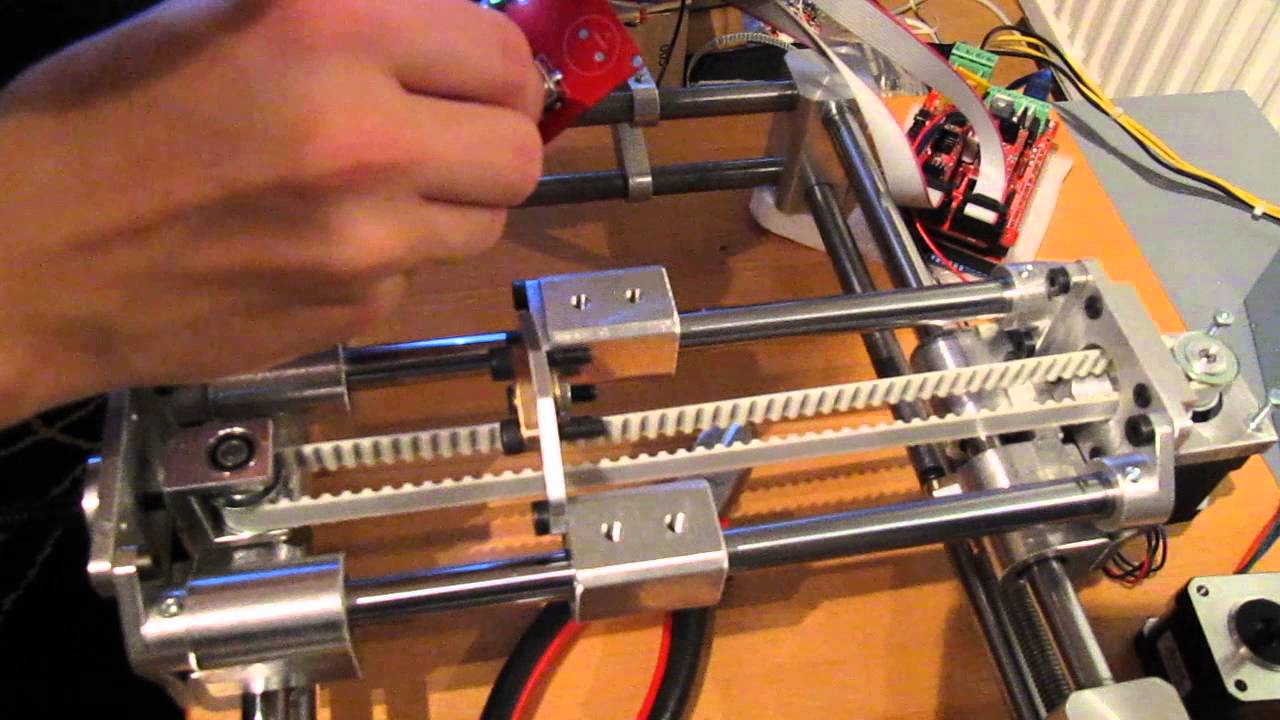

wvmarle:
Something like this, belt driven on 2 rails to move it across the plants.
So I have found a video on youtube of what I basically want to achieve, I will be modifying the design of the structure but it has the basics of what I need. Let me know of what you think of it and any improvements you think it should have.
