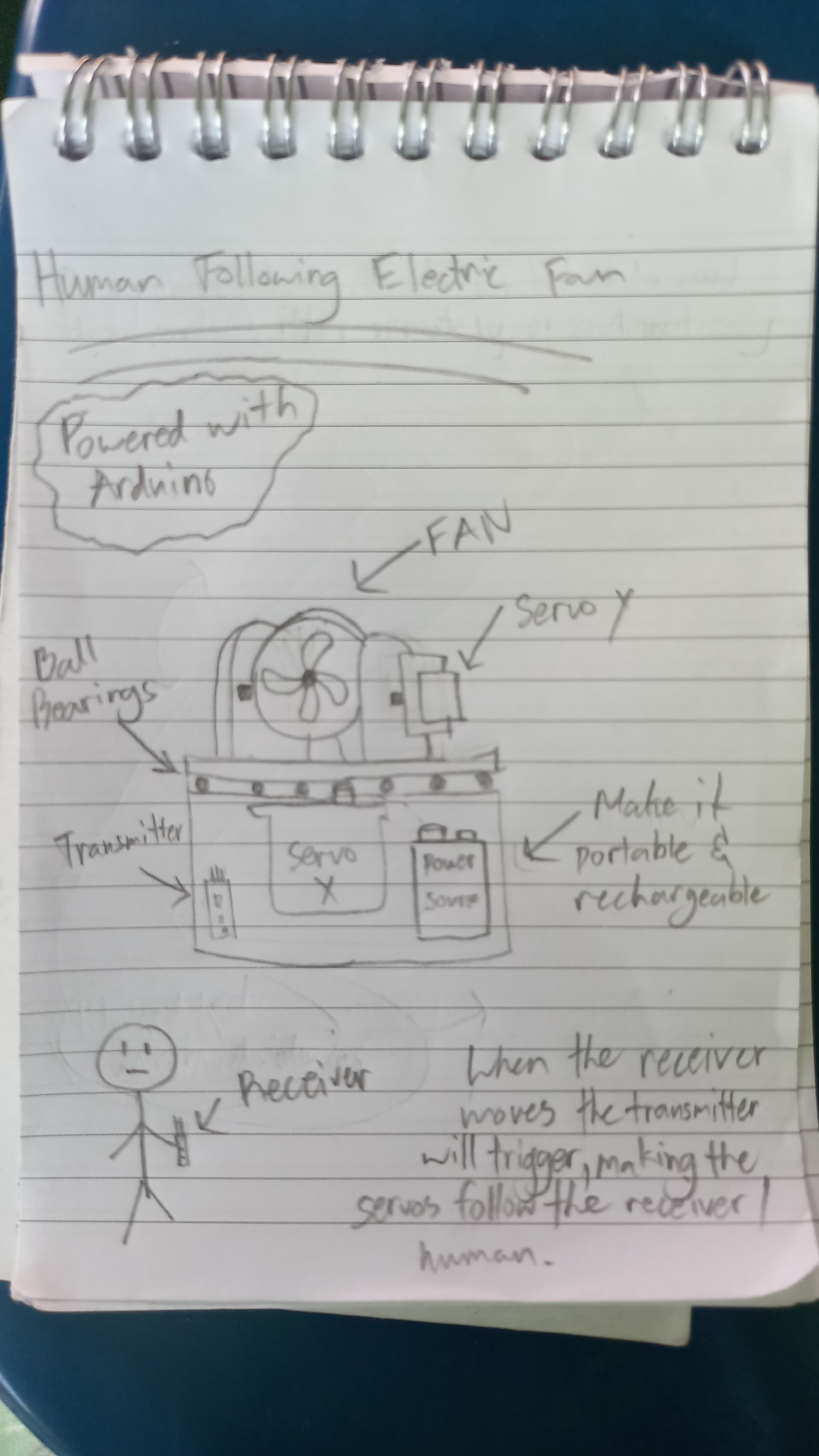

Guys, how do I make like a transceiver that follows a specific receiver. Like, my idea is basically putting sensors, for e.x. Ultrasonic Sensor or Infrared Sensor, to determine the distance, after that I use a bluetooth module or rf for the transceiver and receiver part then I add it to some servos to make it move because I want it so that when a moving object has the receiver, the transmitter/servo automatically follows that receiver/moving object.
Explain
without explanation we will not be able to help

A fundamental question, if the receiver is moving, who will know? Does you design require the receiver to be powered on? Do you have a receiver in mind that will do what you plan?

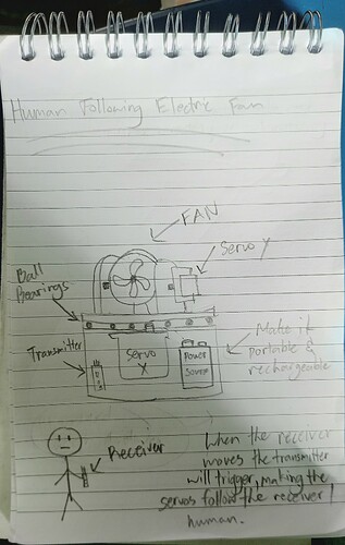

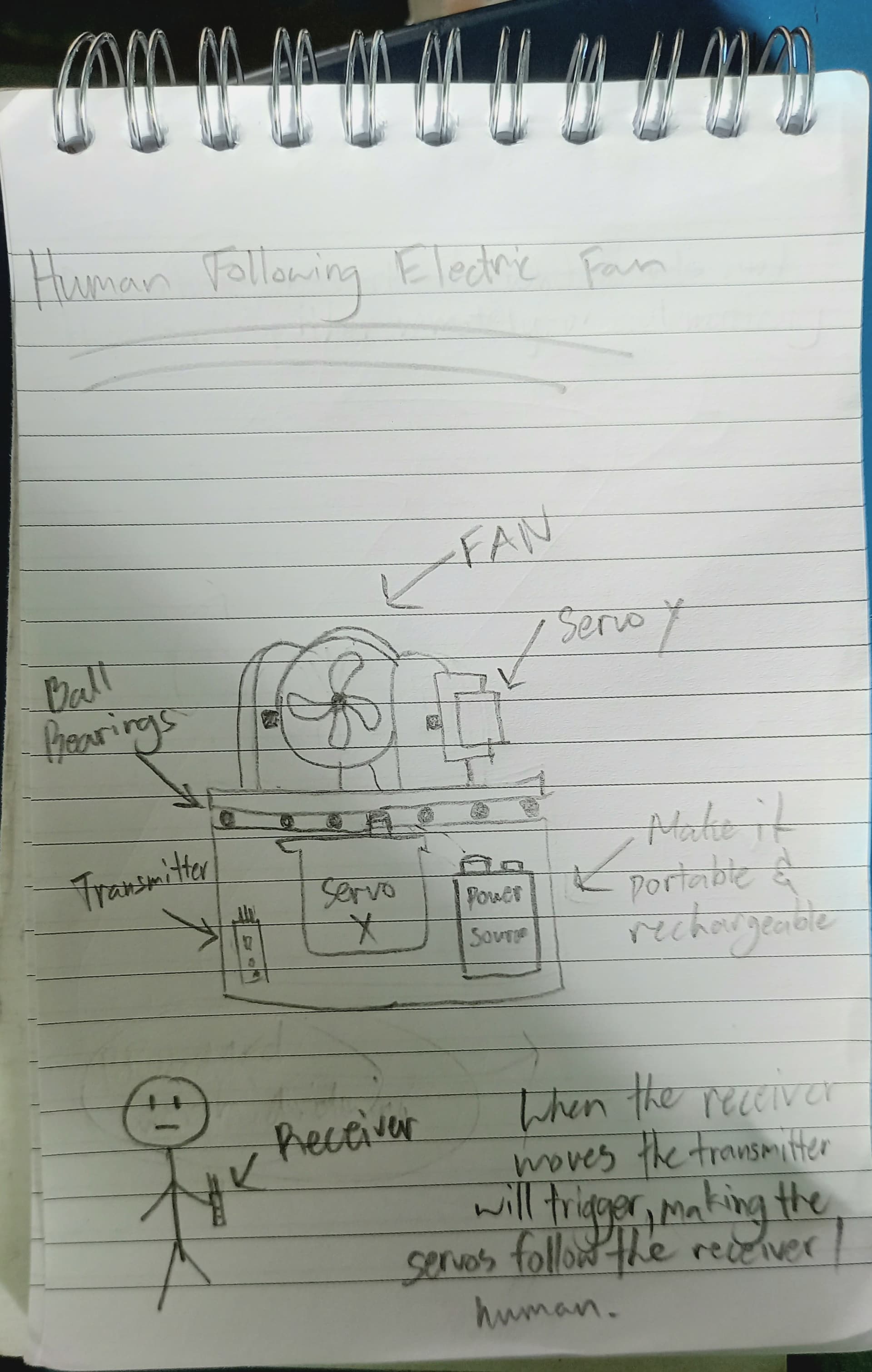

This is basically what I want to do.
Perhaps swap receiver and transmitter. Maybe human has a IR transmitter (i.e. beacon) and your fan has 3 IR receivers. Your code could try and orientate the fan to get the maximum signal on the middle IR receiver.
Maybe this is a variation of the old robot line following technique.
So, are you saying that the human has an IR receiver and the fan has 3 IR and when the human moves in the range of one of the IRs, then the servo moves at a specific position the same direction as the IR that's being activated
Also, how do I use an ir as a "beacon" that correlates with the 3 IRs connected with the servo
No, i'm suggesting the human has an IR (or other form of emitting device) transmitter. Your fan has 3 receivers - one points forward and the other 2 point 5 or 10 degrees off to the sides. The idea is that your receivers are moved to maximise the reception on the middle receiver - i.e. it's pointing at the human.

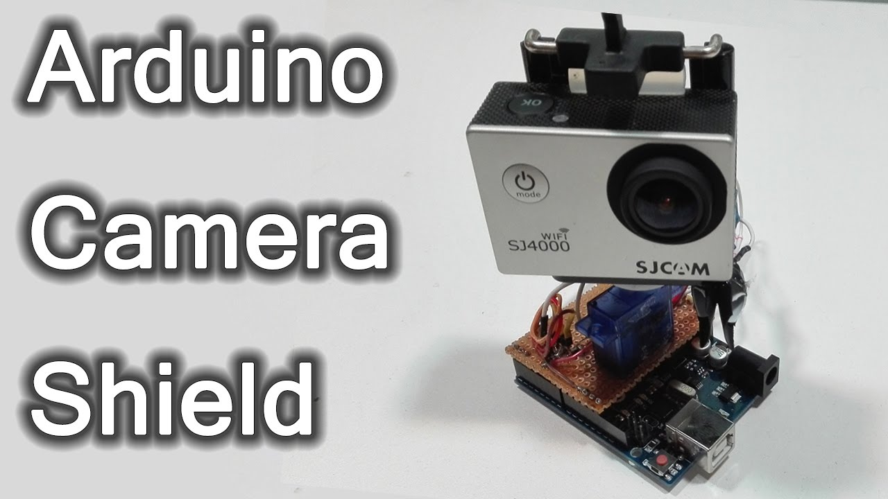

I've not explored further but maybe what this guy has done will be of use (ignore camera and insert fan):
