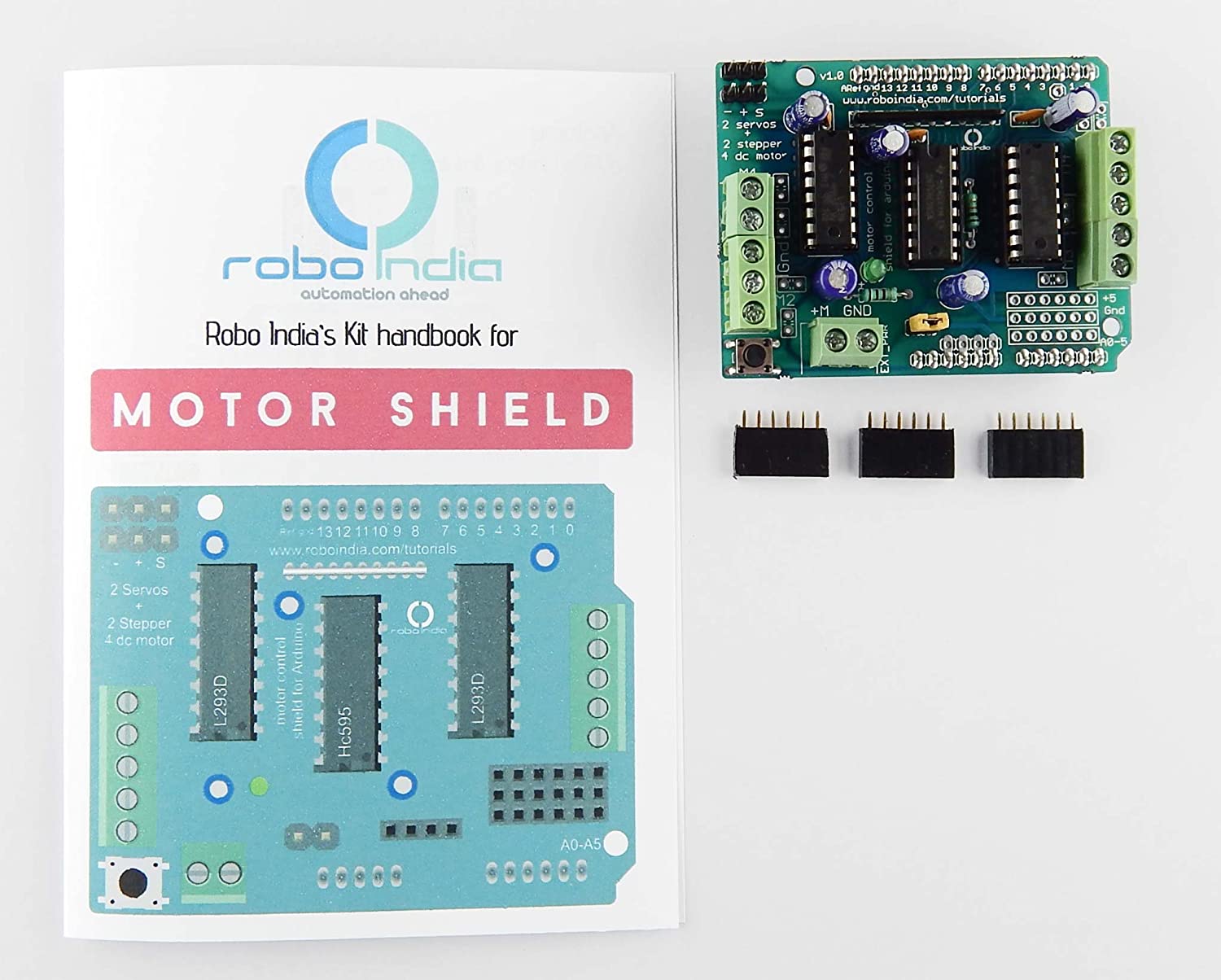

Thanks but there is a problem, It isn't available on Amazon and Adafrruit shipping is risky and slow (Since they are a US based company and I'm in India.) I don't want to sit waiting for the parts to arrive as my event comes closer. I want as much time as I can get for experimenting and testing.
This is a shield I found that could be shipped to me. But looks like its some old version of Adafruit motor shield, can you please review it?
About the Uno I have to use 3 sensors simultaneously as well as control the speed of the motors and take commands from the Pi. DO you think the Uno will stand?
So can you please point out where to buy it? Or suggest some alternative?
