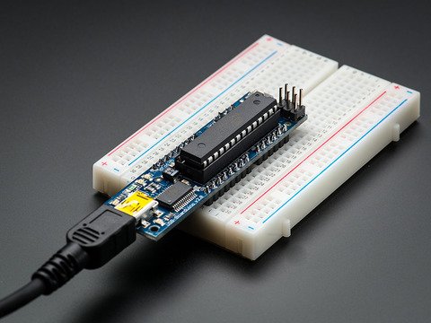

In looking around a bit more this Boarduino looks pretty nice:
Full sized USB, small footprint. I'd have to wire up a 7805 to power it off 9v, but it looks good.
I'm assuming if I add a separate power supply, that running both at the same time (plugging the USB, while it's already being powered) would likely fry something, or is the USB chip smart enough to stop taking USB power?

I'm currently using a Duemillenove for the prototyping, but when it's done, it might be a Boarduino, or Hackduino, or similar small footprint/DIY setup. More than likely a Boarduino with a 7805 added for external power input and regulation.
I'll just avoid plugging in both sources at once, to keep additional circuitry down. I'd only need to use USB once in a blue moon, when loading new software into it.
You say that now, but I guarantee you there will come a time when you are in a rush and/or forgetful because you have something else on your mindandohwhatelsewasIthinkingaboutohdamntheregoes...my...board...!!!
Believe me, despite what you think now, Murphy will get you in the end - especially if you leave a door open for him; take the time to do it right, now.
