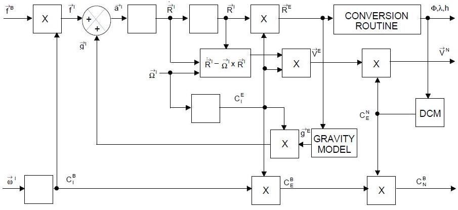

So you want to build an INS (Inertial navigation system). It is a very complex subject and is used in cruise missiles, submarines, aviation..
I do not know the accuracy you get, using a fake mpu6050 china clone. Probably, not very good at all. But if you know the start velocity (probably zero), you can multiply acceleration with time and you get change of velocity, delta v. So you need to get hold of time, for example with the millis function. With velocity x time, you get displacement, "distance". I would go for a different solution, but it would be fun to try it out and see what you actually get of results. You should use a button for start and stop, the mcu do the calculations. The easy calculation is a stright line. Imagine the implications go in a curve....
GPS based can work if the walk is outdoors. 6050 will be like a lottery.

i know mems like mpu have internal pendulums, masses, springs, tuning forks and so... so they also senses gravity force along position changes... so i think i should get the difference between current and past acceleration (delta)??... what represents all those different accelerations (compensated, etc) and what could be more useful for my purpose?
If you assume you start at 0 velocity, have a really good accelerometer and know time it can be done.
In theory it could be reasonably accurate. In practice, not so much.
Not possible with consumer grade IMUs. This blog article explains one of the major problems:
https://web.archive.org/web/20180112063505/http://www.chrobotics.com/library/accel-position-velocity
precision?, i don't care for now
i will just install a theoretical sketch and see how it behaves according my needs... i don't care if car travel 100m and sketch says it traveled 500m
everybody seem obsessed about precision, i just want to see it work... adjusts can be made on the run
It won't AT ALL, but have fun!

If you vehicle runs at a constant speed what will the output from the accelerator be ? Same as if it’s not moving , periods of constant speed will create increasing error.
If it goes over a bump in the road , the accelerometer will register it as an acceleration .
I’d suggest you just try reading the acceleration as the car runs , before worrying about coding distance to see if it looks as though it will work .
Don’t forget “ rubbish in rubbish out”

after researching a little, now i understand this involve VERY complicated realtime calculations, even involving starting conditions, rotation of earth, distance to center, and many other variables
if i want to use dmp instead of raw data is precisely to prevent arduino doing these heavy calculations... because real calculations as i understand should be:
  1. starting with sensor in static position
  2. take some raw samples (accel, gyro) to deduce gravity with this data
  3. enter a loop, where gyro is constantly tracking orientation to update gravity direction
  4. go getting accel raw data and substract gravity vector everytime
  5. the resulting should be the REAL realtime accel, all these while dealing with motion noises
  6. in same loop, go integrating accel and velocity with time interval, to get velocity and distance respectively
  7. go summing these little distances to get travel distance
i want to use dmp to calculate at least up to step 5 (get real accel compensed to gravity, rotations and noises), while let arduino calculate the rest
