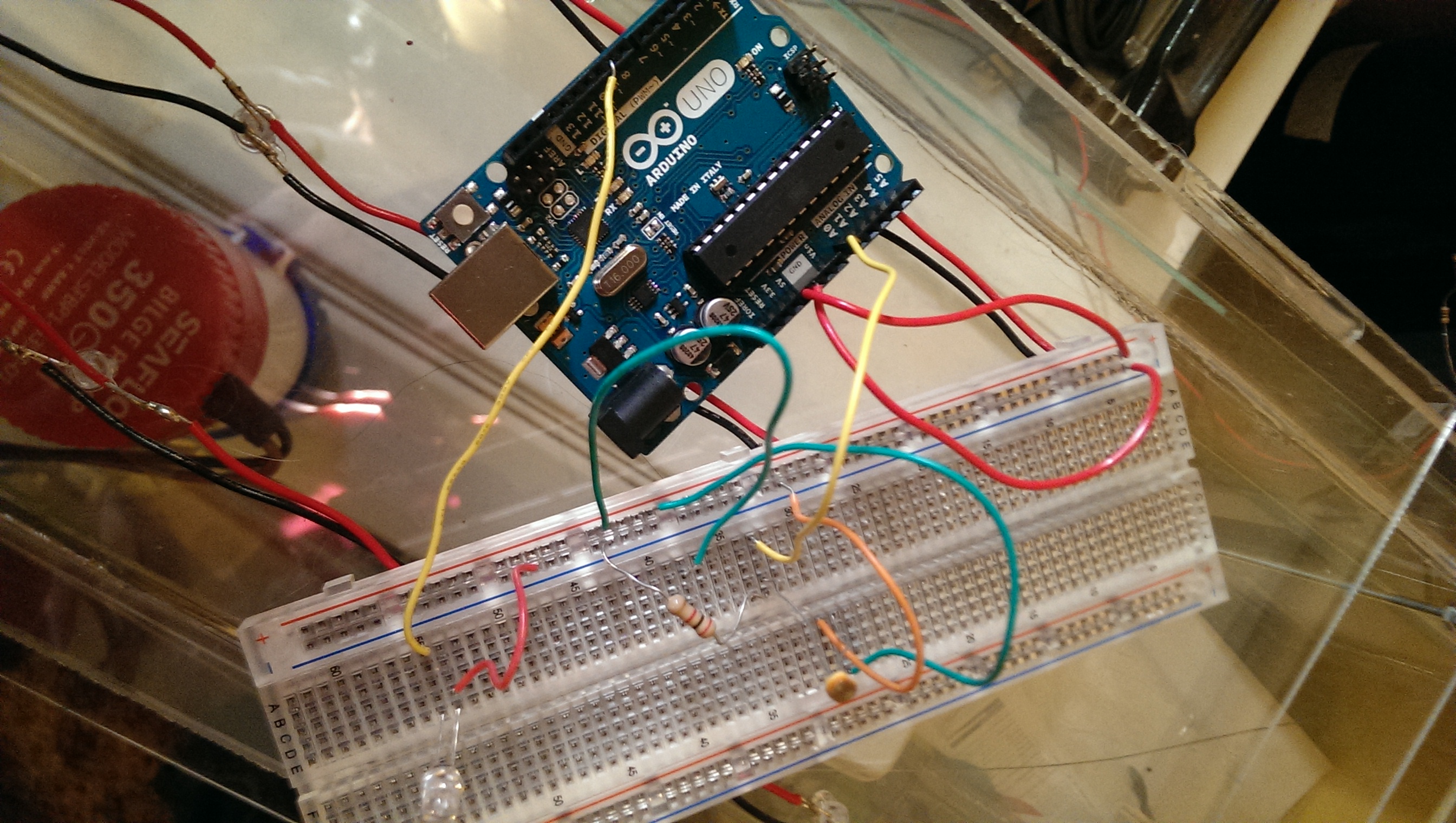

Making LEDS get brighter when it gets darker using LDR? Making them fade up
Im trying to make a circuit in which when there is smoke present the LEDS get brighter depending on the amount of smoke.

I had it setup where the LEDS would turn on HIGH and turn of with LOW
but ive been following a few instructables and none of them seemed to work for me
Is there any way to do this without getting another Optical Dust Sensor?

You've posted over 1.5Mbyte of data, but virtually no information.
A sketch (not a screenshot) and a schematic, please.
Can you please describe:
How the LDR is wired? Please do the drawing of the schematic for us, not a photograph of half of the project.
What it does when you're running that code?
What are you talking about with something being backwards?
As long as the values you're getting back from analogRead() are consistently effected by the level of smoke, it's just a matter of converting the number you get from analogRead() into a number that'll do what you want it to when you send it to analogWrite().
If the smoke chamber with the sensor in it is transparent, or has any sort of windows in it, you'll need to do something to shield your LDR and the emitter whose light it's detecting, to ensure that the results can't be thrown off by turning out the lights (the case to achieve this is probably the source of a good portion of the expense of those dust sensors you were using).

Ok heres an easy one i cant figure out,
When i set it up, i get an analog A0 input of 20 when in full brightness and 0 when i stick something over the LDR.. But i want to convert those numbers so 20 doesnt mean its brighter but it means that the LED is off and when it hits 0 the LED should have full brightness

Some simple arithmetic would seem to be in order then.
I did it! woot woot

int LED = 9;
// initialize serial communication at 9600 bits per second:
// the loop routine runs over and over again forever:
// read the input on analog pin 0:
int sensorValue = analogRead(A0);
// print out the value you read:
Serial.println(sensorValue);
sensorValue = constrain(sensorValue , 0 , 80);
sensorValue = map(sensorValue, 0 , 80, 30 , 0);
analogWrite(LED, sensorValue);
delay(250); // delay in between reads for stability
