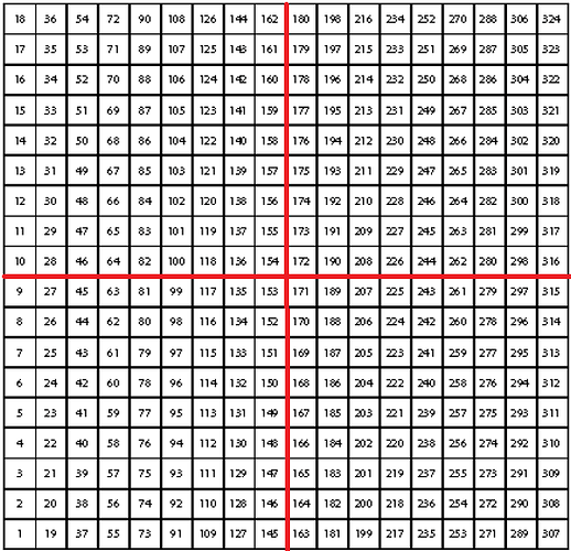

I am interested in simulating a mouse pointer (say a square on a Cartesian coordinate system). I would need to convert DELTA_X & DELTA_Y data received from ADNS2610 Optical Mouse Sensor.
Looking at the datasheet, there is an 18 x 18 matrix of possible pixel read ranges. I divided the matrix into 4 parts, where each part can potentially mean a direction of movement:
I wrote a small app which lights up each pixle when data is receive just to get a visual understanding. And sure enough, parts of each quadrant would light up when the sensor is moved UP, Down, LEFT, or RIGHT.

My issue is with understanding the DELTA_X and DELTA_Y. I have no problems in plotting, graphing or hardware design.
The work of the ADNS2620 as defined by the datasheet:
"It is based on optical navigation technology, which measures changes in position by optically acquiring sequential surface images (frames) and mathematically determining the direction and magnitude of movement."
"The output format is a two wire serial port. The current X and Y information are available in registers accessed via the serial port."
"Register Address Notes
Delta_Y 0x42 Y Movement
Delta_X 0x43 X Movement"
"Delta_Y USAGE: Y movement is counted since last report. Absolute value is determined by resolution."
"Delta_X USAGE: X movement is counted since last report. Absolute value is determined by resolution."
The the datasheet provides a table/matrix which is described as:
"Pixel Map (sensor is facing down, looking through the sensor at the surface)"
Here is a picture of it, I modified the image by adding two red lines to divide the matrix into quadrants (to better understand the numbers).
Imgur
Other optical mouse sensors provide negative and positive values. The ADNS2620 provides positive values ranging from [1-324] for each X & Y delta.
Where did I go from here? Well, with my assumption of "Quadrants", I am able to get a sense of the movement direction by checking "Quadrant" range values through my getDirectionInt method/function. I then create my own "movement delta" which is a static value of how much should my simulated mouse pointer (Square) move on a Cartesian coordinate system.
Currently my simulated pointer (Square) is not moving very fluidly, and that is due to my constant movement delta, which has no association with the actual speed of mouse movement. I am trying to figure that out.
I hope this is a little more clear than my first attempt.
Am I going about this the right way?

I think you're mixing up two things which aren't related. The matrix with 324 cells you posted is just a picture the sensor took. If you want to use the sensor as a mouse, I think it has no relevancy and you can ignore it and you just need delta_X, delta_Y and the elapsed time since you last read those registers.
Whenever you read those registers, they tell you how many units - whatever those are - the mouse has moved in that direction since you last read the same register. Values go from -128 to +127. If you read those values with more or less constant frequency, you wouldn't have to worry too much about the time difference as it's constant. If it varies widely, you need to take it into account. Depending on the reading frequency, the values delta_X and delta_Y vary. In the most simple case, the code is something like:

I would love to ignore the matrix of 324 cells. However, the values that represent DELTA_X_REG and DELTA_Y_REG range from 1 to 324. I never receive data in the range -128 to +127. I have seen other optical mouse sensors that do, including the PAN3101.
There must be some scaling related to the 1 to 324 range, unless I am still missing the big picture :~
I corrected my code above to read in signed bytes. then you have -128 to 127.
Korman
Korman, thank you for the clarification. I am still unable to obtain range values from +127 to -182, even if I declare delta values as uint_8t. I am currently sending delta values upon request to not overload my "mouse". I prefer to do the processing at the receiving end (C# application). I am not interested in emulating the mouse at the OS level; moving a square would be more than enough.
When I send values over the wire, they are converted to DEC which bring back 1 to 324 range.
If I can scale the values to [+127 -128] this would at least fix the Square x & y increments. I then will need to figure out the speed, which should be doable.
All I would like to do is move a Square drawn on a picture box (C# application) by moving my "mouse". I easily control the drawing functionality of the Square. However, I am stuck at decoding the mouse delta values to help me.

Not uint8_t, that's unsigned and a range from 0 to 255. int8_t is the signed version which goes from -128 to 127.
I hope that clears it up.
Korman
Korman, it all makes sense now.
I initially used int_8t, which resulted in compile errors. I tried to look it up but no luck. I then used uint8_t because it compiled (you pointed out I shouldn't).
However, int8_t did the trick. With all my decoding at the application level (C#), I am still missing a couple of tweaks; but I can handle them.
