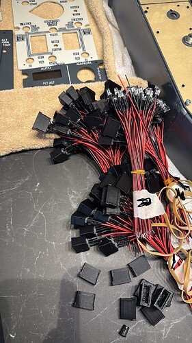

Hey,
I have a project that will have:
  1. 150 buttons.
  2. 15 - 7 segments display
  3. 3 rotatory encoders
  4. 15 servos.
  5. 200 leds (100 pins , 2 leds chain for each pin )
For that I will use 7 Arduino mega boards.
Servos will be connected to external 5v power supply.
My question is regarding the leds. In some scenarios 50% of the leds can be powered in the same time. I am not sure how many 5v leds the Mega can support simultaneity??
I can try to spread them around the 7 Mega board which will make around 30 leds per board. Again each two leds are chained together into one pin(~15 pins per Mega for 30 leds ).
I prefer to have two Mega boars that will managed all leds but I am not sure Mega can support leds on all pins turned on in the same time.
Those are the leds I have Link

From the question, it seems you are wondering if the Mega can supply current to all the LEDs. This is the wrong approach to design. You should not consider the Mega as a power source for the LEDs, the power supply should be external anyway. The same applies to seven-segment displays and servo motors.
Can you share with me an example how led can be powered by external source?
The led has only 2 wires, how can I bridge it with external power?
There is Mosefet that can control large number of leds?
Each box led has two leds chained together.
I need the ability to control each led box separately.
That link shows a large number of LEDs with and without flashing, what have you actually got?

If you need to control each LED separately, you need a mosfet for each.
For small LEDs you can power an anode with an external power and switch the LED by GND. Foe the power LEDs you need a mosfet to switch ether on high or lower side.
I know how to do it for the servo and 7 segment as they have 1 wire for 5v and other wires to control the unit(that connected to the Arduino). But for a led there are only two wires. So what is connected to the Arduino and what to the external power supply?
Using a N-mosfet to switch a LED by lower side:
(GPIO is an Arduino pin, +12v just an example)
What is the LED current range? Do you have a datasheet for it?
I have 5v white/yellow led.
So having 100 mosfets?
To be able to answer this I need a LED specs as asked you in #12
I think it 20MA .
Does it make sense?
20 mA * 200 LEDS = 4000 mA = 4A
According to the specs of the different arduino boards posted above, the total current across all pins should not exceed 700mA, so your setup exceeds that by about 6 times.
So you need mosfets for each pair of diodes.
By the way, have you considered the addressable led strip? You can connect all 100 diodes to one pin and you won't need mosfets
However you look at it, 200 LEDs is a lot of LEDs. This is a job for at least ULN2803, or if you want to reduce IO pins TPIC6B595. You will need 25 such devices (25x8 = 200).
It appears the LEDs you bought have a series resistor in the leads, so if you drive 2 in series you will get half the current, and probably less than half the brightness. It would be better to use 2 regular LEDs in series with a single resistor in series. I guess you could still remove the resistor from the leads.
To make your life slightly easier, there are breakout boards for TPIC6B595 available (bare PCB, so get ready for some soldering).
The TPIC6B595 could easily handle two in parallel with a 5V power supply, or two in series with a 10V power supply.
An HT16K33 could be used for the 15 7-segment LEDs, if multiplexing is acceptable, or just use more TPIC6B595s to reduce the pin usage. Depending on what this is all for, the Mega may not be the best choice anyway.
Not really.
The LED specification says 0.1W. At 5V that would be 100mA.
The only way to know for sure is to the measure the current.
